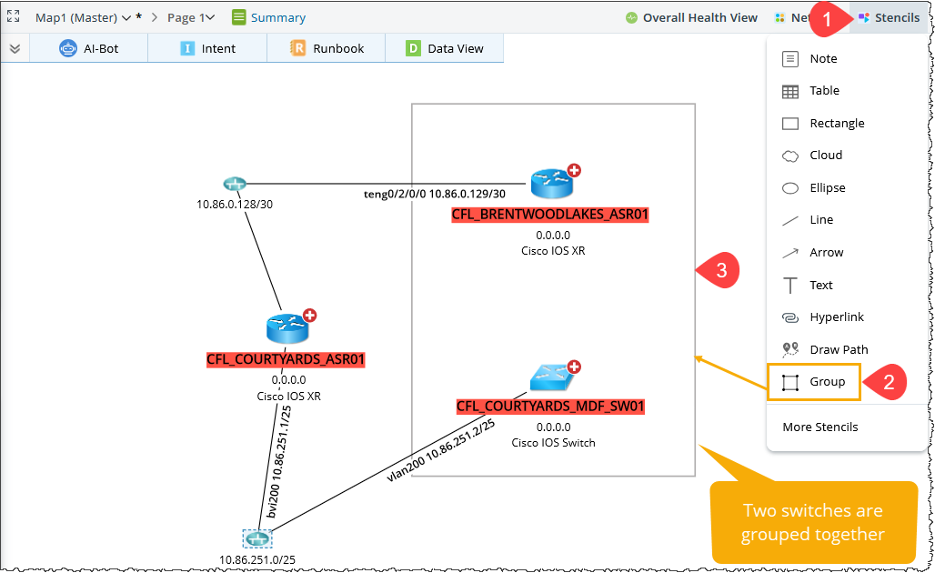

Group the Map Elements using the Stencils Menu
To group map elements, follow these steps:
  1. Open the map and navigate to the Stencils menu.
  2. Select Group from the dropdown.
  3. Draw a rectangle around the elements you want to group. Once the rectangle is drawn, the selected elements will be grouped.

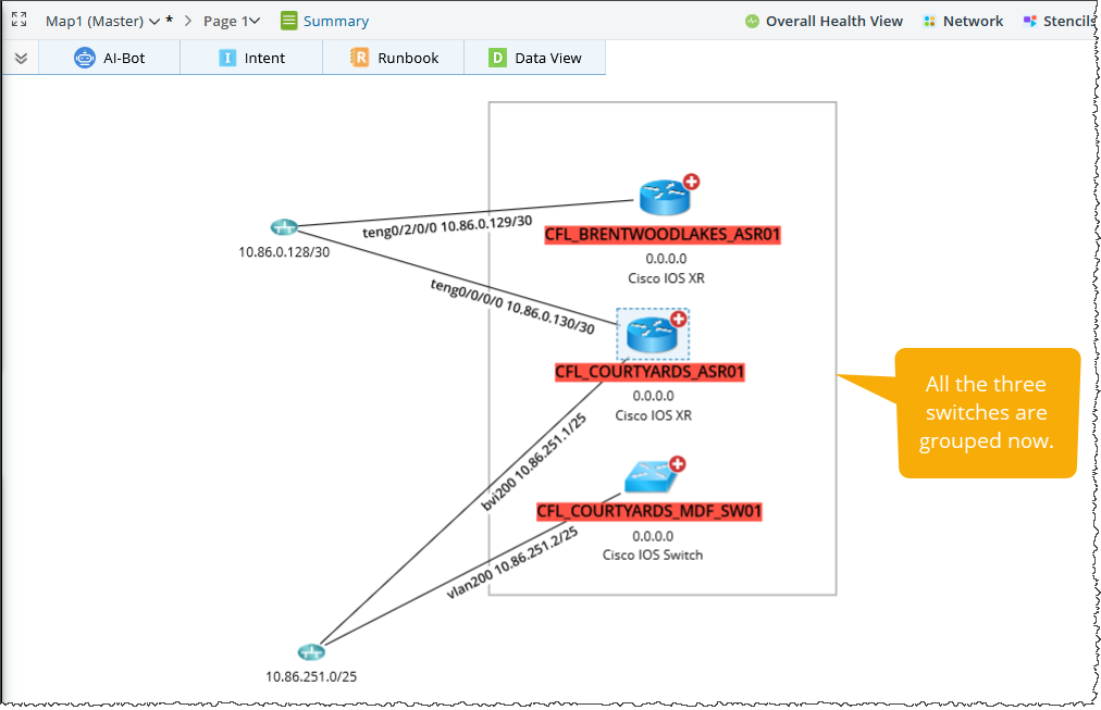

Adding Non-Group Elements to a Group
Elements, excluding group elements, can be added to a Group. In the previous image, two switches are grouped. In this step, another switch will be added to the existing group.
  1. Drag the element you wish to add to the existing Group.
