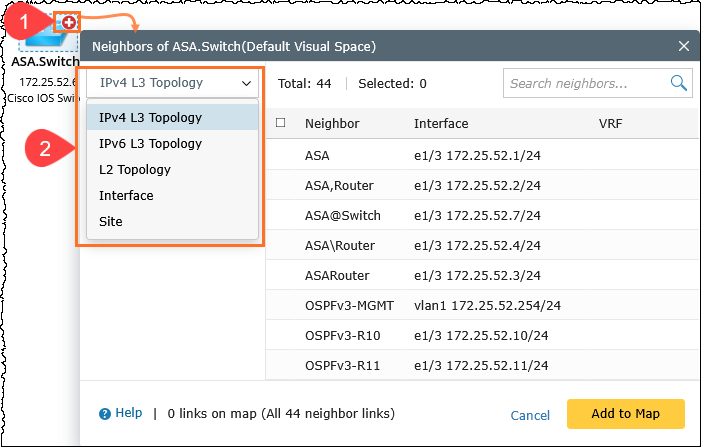

  1. Click the icon attached to the target device on your map.
    Information Tip: You can manually resize the extent neighbor window by dragging any of the four corners of this window.
  2. Select a neighbor type from the drop-down menu to filter neighbors:
    • IPv4 L3 Topology
    • IPv6 L3 Topology
    • L2 Topology
    • Interface
    • Site
    Note: Enter an IP address or parts of an IP address in the left pane's search bar to refine or locate interfaces.

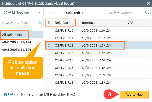

  3. Choose one or multiple neighbor devices, then click Add to Map. Alternatively, double-click All Neighbors to include all listed neighbor devices on the map.
    Note: Use the right pane's search bar to find specific neighbor devices or sites.
  4. Repeat the above steps to extend the neighbors for more devices.

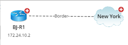

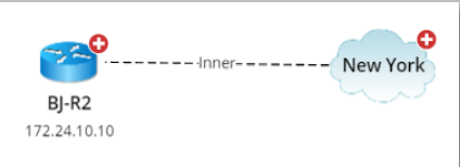

Connectivity Between a Device and a Site
When you extend neighbor devices for a site, the connectivity on a map might be one of the following:
Table 2 - Neighbor Devices (for Site) Connectivity on Map
Connectivity on MapDescription
Graphical user interface
Description automatically generated with low confidenceThe device is an inner device of this site, indicating that it is not connected to any devices from other sites.
A picture containing table
Description automatically generatedThe device does not belong to the site and is connected to a device (BJ-R1) within the site.
A picture containing graphical user interface
Description automatically generatedThe device is a border device of this site, indicating that it is connected to devices of other sites.
