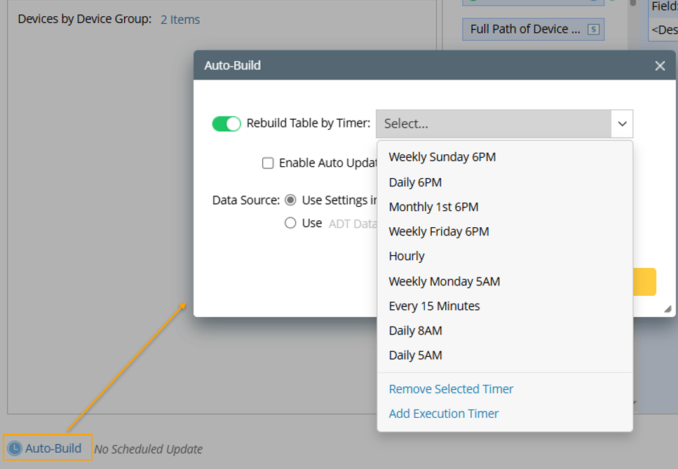

To use the Auto-Build functionality, complete the following steps:
 From Base tab or Group tab in the Automation Data Table Builder, click Auto-Build.
  1. In the pop-up Auto-Build dialog, choose any one of the options from the following list:
    1. Turn on Rebuild Table by Timer, then select a proper Timer available in the system.
    2. You can remove the selected timer by clicking Remove Selected Timer.
    3. If the existing Timers cannot meet requirement, you can set up a new timer. Click Add Execution Timer and set up a Timer in the dialog. Then click OK, and the created Timer can be selected for automatically building ADT data.

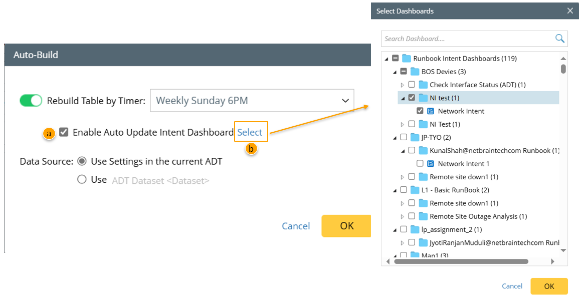

  2. You can Auto update after building the contents of ADT:
    1. Select the Enable Update Intent Dashboard checkbox.
    2. Click Select and then select a dashboard from the Select Dashboards window.
  3. Select Data Source. The data source for building ADT data can be selected. For more information, see Specify Data Source for Building ADT Columns
  4. Click OK in the Auto-Build dialog to set up Auto-Build.

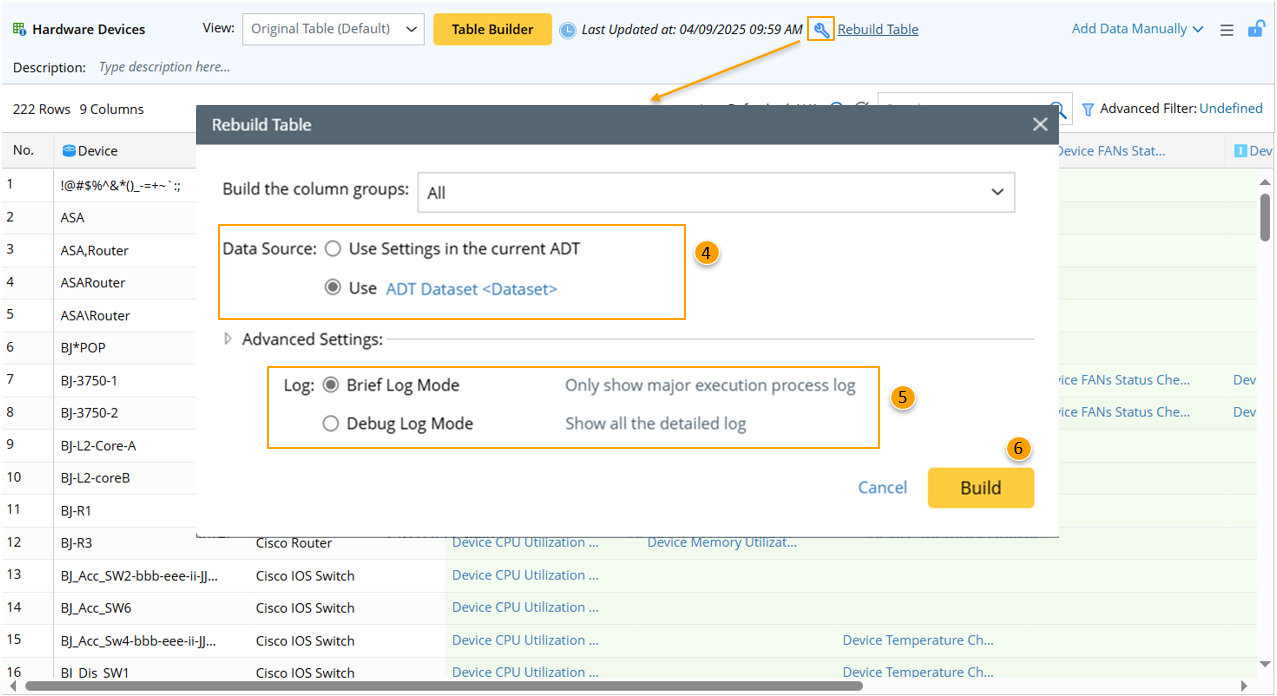

To manually update table data, click Rebuild Table from an open ADT.
By default, all the column data will be rebuilt, however, you can specify some of the columns in ADT for rebuilding table data by configuring Rebuild Table Settings, which will speed the data rebuilding process (for more information, see Select Column Groups for Building/Rebuilding ADT Data). Moreover, the data source for building ADT data can be specified. For more information, see Specify Data Source for Building ADT Columns
When you click Rebuild Table, the Build Table dialog appears. You need to define settings as per your preferences. After defining setting, click Build, you will see when the table data rebuilding is in progress. The last time of rebuilding table data (Last Updated at:) is displayed after the process is completed.

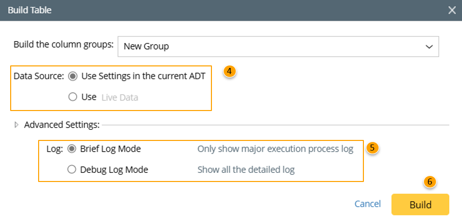

  1. Open Table Builder of an ADT.
  2. After defining column groups, click the Save and Build button.
  3. In the Build Table Settings dialog, select column groups for building ADT data. By default, all column groups are selected.

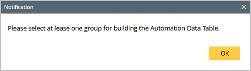

    InformationNote: User must select at least one column group to build ADT data. An error message will prompt the user if no column group is selected.
  1. In the Data Source section, select the data source for building ADT data. For more information, see Specify Data Source for Building ADT Columns.
  2. In Advanced Settings Log section, select a log mode.
  3. Click Build to apply all the settings and build ADT data.
If table data is rebuilt manually, column groups can also be specified for rebuilding table data by configuring Rebuild Table settings. The column group data that is updated will be merged with the data of the unselected column groups.
  1. Open an ADT from Automation Data Table Manager.
  2. Click placed before the Rebuild Table button.
  3. In the Rebuild Table dialog, select column groups for manually rebuilding ADT data. By default, all column groups are selected.
  4. In the Data Source section, select the data source for building ADT data. For more information, see Specify Data Source for Building ADT Columns.
  5. In the Advanced Settings Log section, select a log mode.
  6. Click Build, the rebuild table settings will be applied during the process of rebuilding table data.
