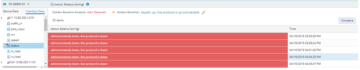

String-Type Variable:
The values are displayed in a table, and the off-normal item is highlighted in red.

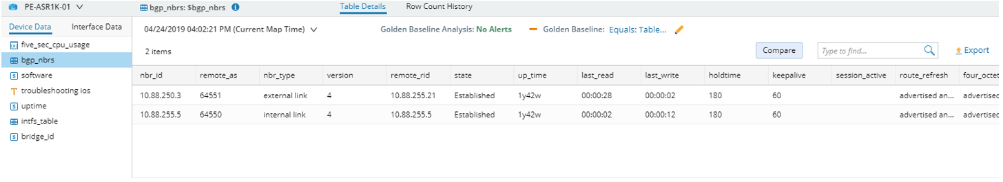

Table-Type Variable:
Only the current values are displayed. If there are any off-normals, alerts will be displayed in the Golden Baseline Analysis field.
