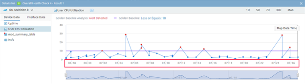

Number-Type Variable:
The values are displayed in a chart, and red dots refer to off-normal items.

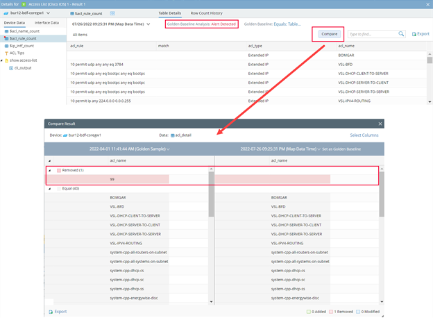

String-Type Variable:
The values are displayed in a table, and the off-normal item is highlighted in red. You can click the highlighted string to see alert details.
Table-Type Variable:
Only the current values are displayed. If there is any anomaly, alerts will be displayed in the Golden Baseline Analysis field. Click  to view alert details.
