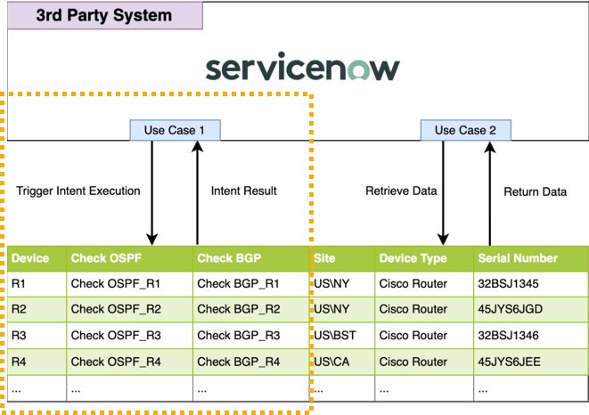

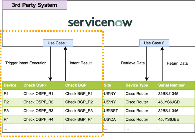

Use Case 1: Trigger ADT Intent and Get Results
Users can call APIs from the 3rd-party system to trigger a network intent, and get the task status; When the task is completed, send an API call to obtain the execution result.
3rd-Party API Call Trigger Intent Execution
An API call sent from the external system calls NetBrain TAF Lite to trigger the network intent(s) located in a specific ADT view and retrieve the execution result.

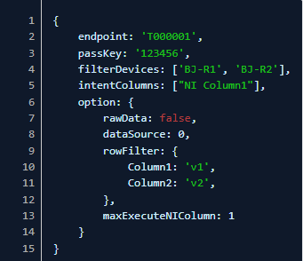

Sample Input and Output:
Input
A screen shot of a computer program  Description automatically generated
Output
A screenshot of a computer program  Description automatically generated

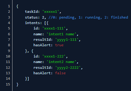

Input
Output
A computer screen shot of a code  Description automatically generated

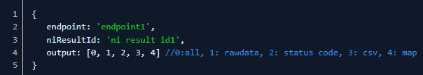

  • Input Parameter:
    Parameter Type Required Description
    endpoint string Yes The endpoint generated by the system when users add an ADT view to TAF Lite.
    niResultId string Yes The intent result Id
    output array Yes
    The result type returned to the 3rd-party system.
    • 0: return all types of data
    • 1: return status code and messages.
    • 2: return raw data
    • 3: return a CSV file type
    • 4: return map id, map name, and map link.

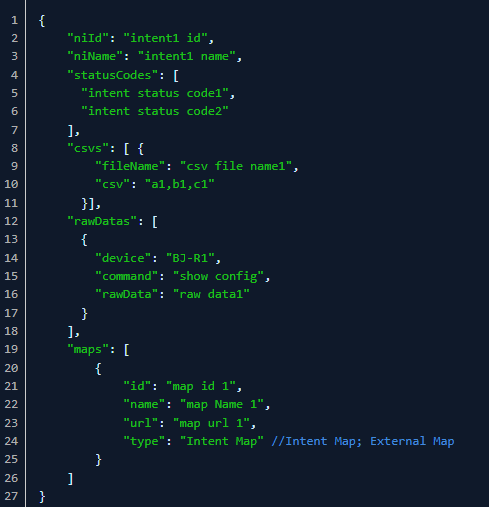

Input:
 A blue and white text on a dark background  Description automatically generated
Output:

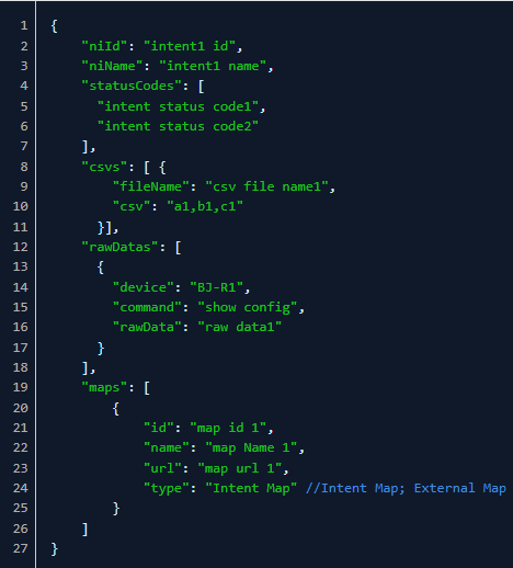

Input:
Output:
