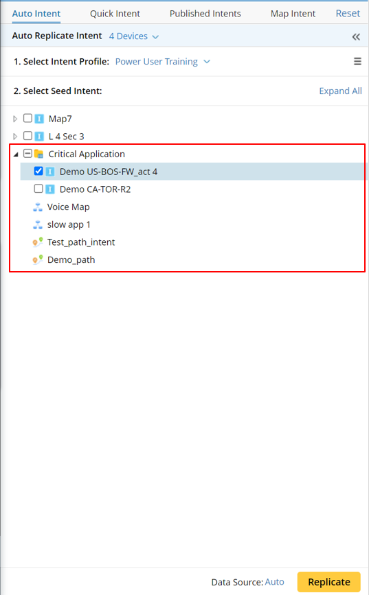

To fully understand and troubleshoot an issue, it is normally required to analyze the related maps and paths besides intents. In such events, power users can employ the feature – enabling ADT assets (Intent/Map/Path) to be used in Auto Intent. This function will enable finding automation assets for map devices, e.g., device-related failover links and the map, device-related path, and the path intents. Then the automations assets can be used in Auto Intent by end users.
Under the ADT node, the intents related to the ADT, the path in ADT and the map related to the ADT are displayed. It is noted that when your select to view an ADT intent, the Input Macro Variable area will not be displayed, because ADT intent does not have configurable macro variables.

Use Intents from ADT to Create an Intent for Troubleshooting.
To use an ADT intent, follow the major steps below:
  1. Select the ADT intent from the Auto Replicate Intent Pane.
  2. Click the Replicate button to run the ADT intent.
    Information Note: The intent under the ADT node is intent instance, not intent template. Therefore, clicking the Replicate button will actually run the intent.
  3. View the intent diagnosis to analyze and resolve network problem.
