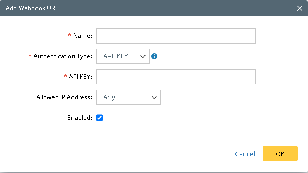

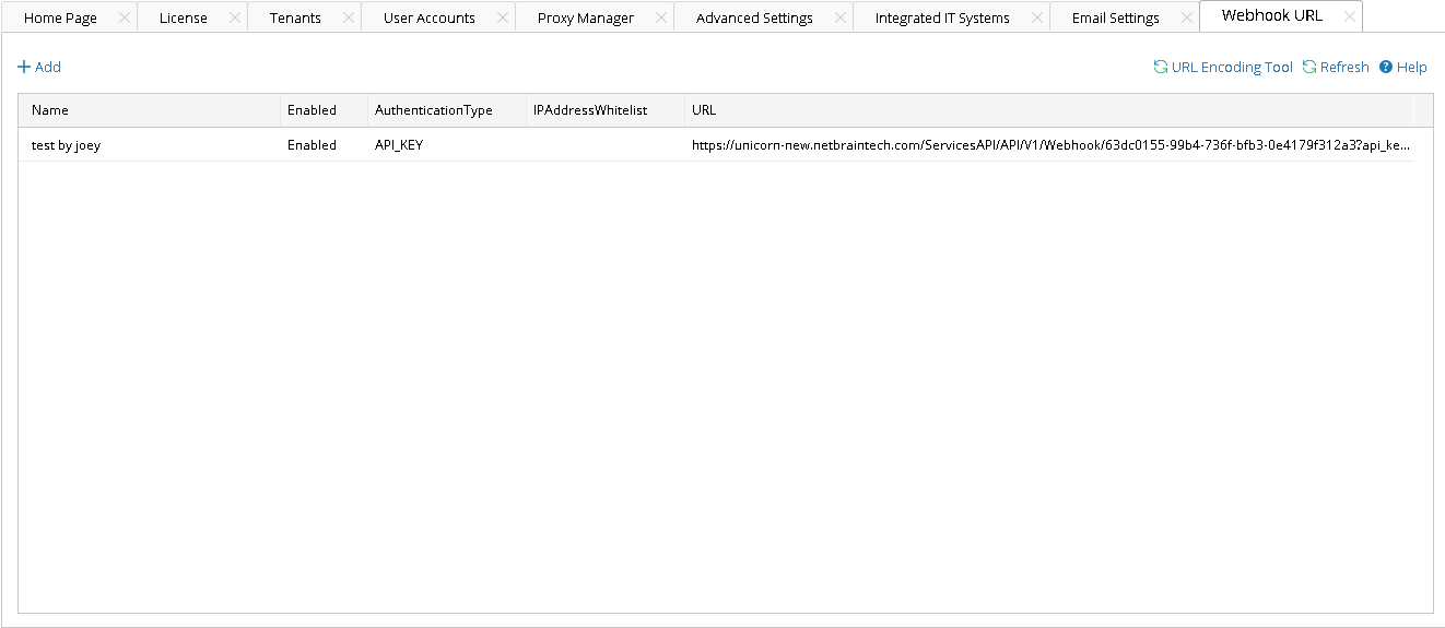

The Webhook URL can be created and enabled in the NetBrain system to use API calls to build a connection with the NetBrain system. To enable Webhook URL, complete the following steps:
  2. On the System Management page, Click  and select Webhook URL.
  1. Under the Webhook URL tab, click +Add.
  1. Complete the required fields (Name/AuthenticationType/API KEY) and select the Enabled check box.
  2. Click OK.

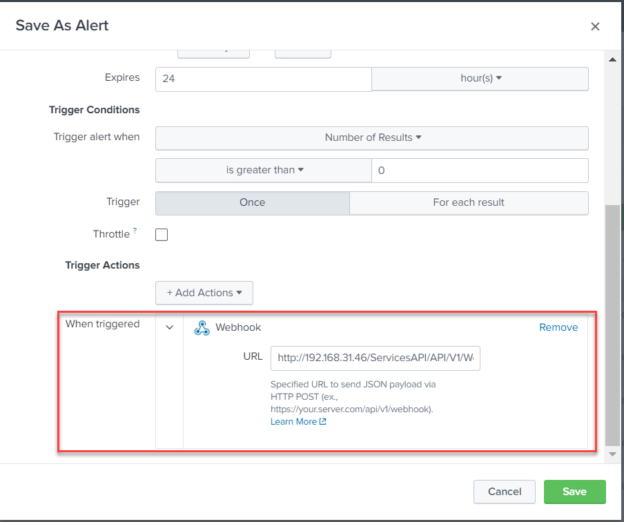

Define Webhook Alert Action
Webhook alert action is used to define the Webhook URL to create NetBrain map and execute Runbook Template when Splunk alert is generated. The following screenshot exemplifies the Save As Alert interface in Splunk App.
