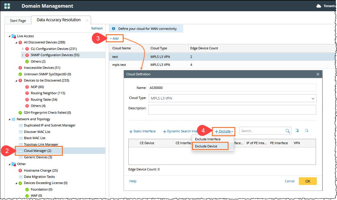

Follow these steps to exclude all the Google Cloud Router devices:
  1. In the Domain Management page, click  and open Data Accuracy Resolution.
  2. Open Cloud Manager from the Network and Topology folder.
  3.  Click +Add to open the Cloud Definition window.
  4. Click Exclude and select Exclude Device from the dropdown.
  5. Select the Google Cloud Router from the dropdown menu, and click the icon to move all selected devices to the right pane.
  6. Click OK to finish.
    Information Note: Failure to exclude all the Google Cloud Router devices connected to MPLS may cause the path calculation issue. If you have any issue creating MPLS Cloud in the NetBrain System, contact NetBrain Support.
