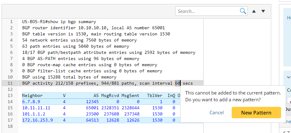

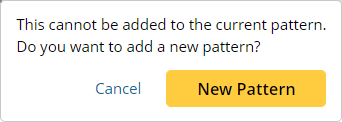

  • If you continue to select multiple lines from the sample data to parse a table, a tip message prompts you to either add a new table pattern or save the current pattern.
  • If you add one for more variables by selecting words in the input area, the variable will be parsed in the current pattern (if the current pattern is multiple mode, the variable will be parsed in the current paragraph).
  • If the selected variable is in the same line with an existing variable, the system will decide whether to merge the new line pattern to an existing line pattern according to the following rules:
    • If the existing variable is parsed by regex, mregex, LineByKeyWord, LineByVariable, LinesByRegex, SelectVariable functions, the new line pattern will not be merged into it.
    • If several existing line patterns of the same line are found, the new line pattern will be merged into the first mergeable existing line pattern.
      Information Note: In multiple mode, if the ID Line is empty or no variables are matched with it, the new variable will be added to the ID Line first.
  • If the added variable is not in the same line with the existing variable, a new line pattern will be generated for this new variable.
  • If there is an empty line pattern, the new variable will be added to it without following the above merging logic.

  • If multiple lines are selected to parse variable in a table pattern, a tip message prompts users to create a new pattern.
  • If you add one or more variables by selecting words in the input area, the variable will be parsed in the current pattern.
  • If the added variable is in the same line with existing variable, the system will decide whether to merge the line pattern by the following the rules:
    • If the added variable is parsed by regex, mregex, LineByKeyWord, LineByVariable, LinesByRegex, SelectVariable, the variable will not be merged into the line pattern.
    • If only one pattern line is matched, the variable will be merged into this pattern line.
    • If several Var lines are matched, the variable will be merged into the first one.
    • If the parser is a collector parser, the added variable will not be merged.
  • If the new variable to be added is not in the same line with the existing variable, the variable will be added to an empty pattern line (if exists), or a new line pattern will be generated for this new variable.

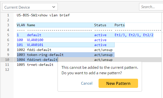

  • In table pattern, when users continue to select several lines to Parse Table:
    • When the current table headers are not defined, the new variable will be added to the current table pattern.
    • When the current table headers are defined, a tip message will ask you to create a new table pattern.
  • In table pattern, when users add variables that are not in table pattern, a tip message prompts users to create a new pattern.
