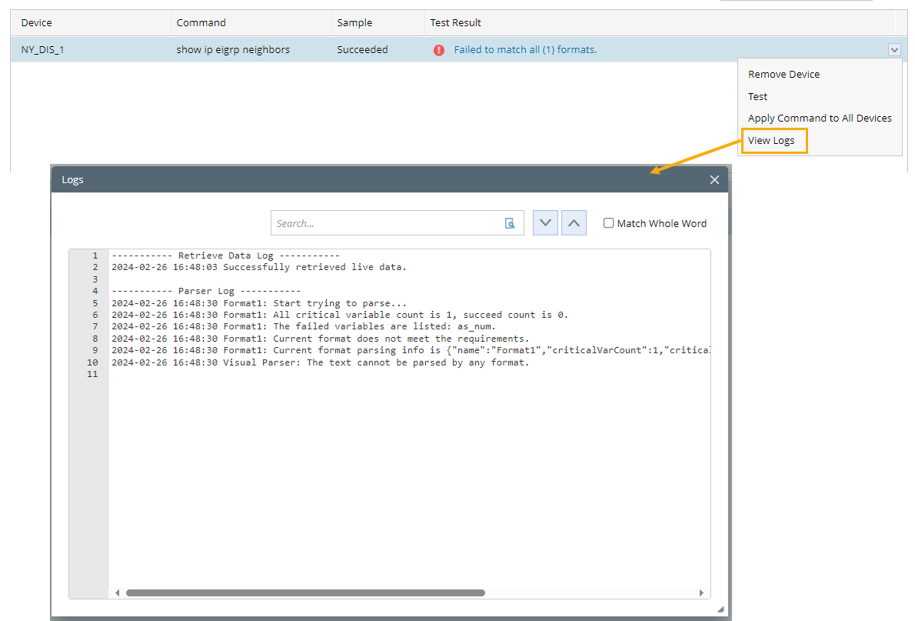

  1. Select an error and view the log. The log documents the retrieval and parsing process, providing helpful insight for debugging.
    The log reveals that the critical variable cannot be parsered.

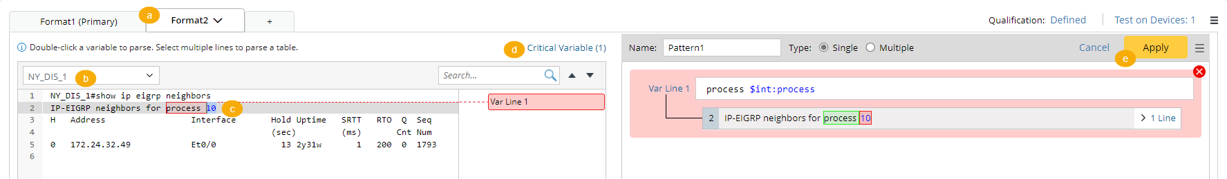

  2.  Open the parser.
  3. Identify the reason why the critical variable is not being parsed: The format on NY_DIS_1(for process $var) is different from that on Sanjose_Core(for AS($var)).
  4. Modify the parser definition.
    1. Add a new format.
    2. Select NY_DIS_1 as the device.
    3. Select 10 and click Parse Varibale.
    4. Define  $process as a critical variable.
    5. Click Apply.
