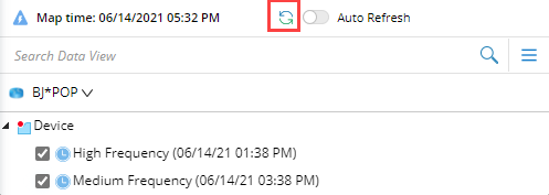

  1. Refresh on Map
    Clicking the refresh icon will set the map time to the current browser time. The latest Flash Probe and Monitoring Variable result will be displayed on the map.

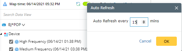

  2. Auto Refresh on Map
    Define the refreshing frequency after checking the Auto Refresh option. The map time will be set to the current browser time based on the frequency settings. The latest Flash Probe and Monitoring Variable result will be displayed on the map accordingly.

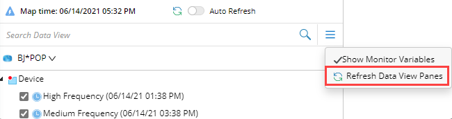

  3. Refresh Probe Data View Pane
    Refresh Data View Pane allows you to update the Flash Probe and Monitoring Variable result in the Probe Data View Pane, but the map time will not be reset.
