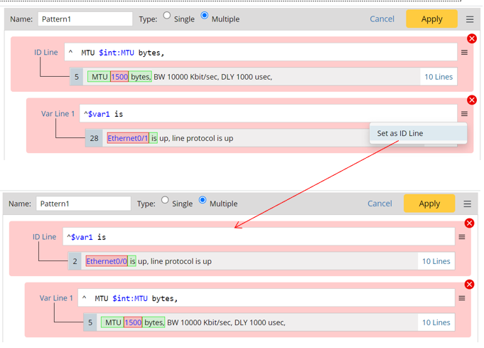

ID Line in Auto Parser (Multiple Type)
In a multiple-type auto parser, the first line pattern is the unique one ID Line for dividing lines of text into segmented paragraphs, then Var Line patterns are added after the ID Line pattern to define more variables in the same paragraph.
You can change a Var Line to an ID Line from the menu Set as ID Line of the Var Line, then the target Var Line will be placed at the top as the beginning of the paragraph.

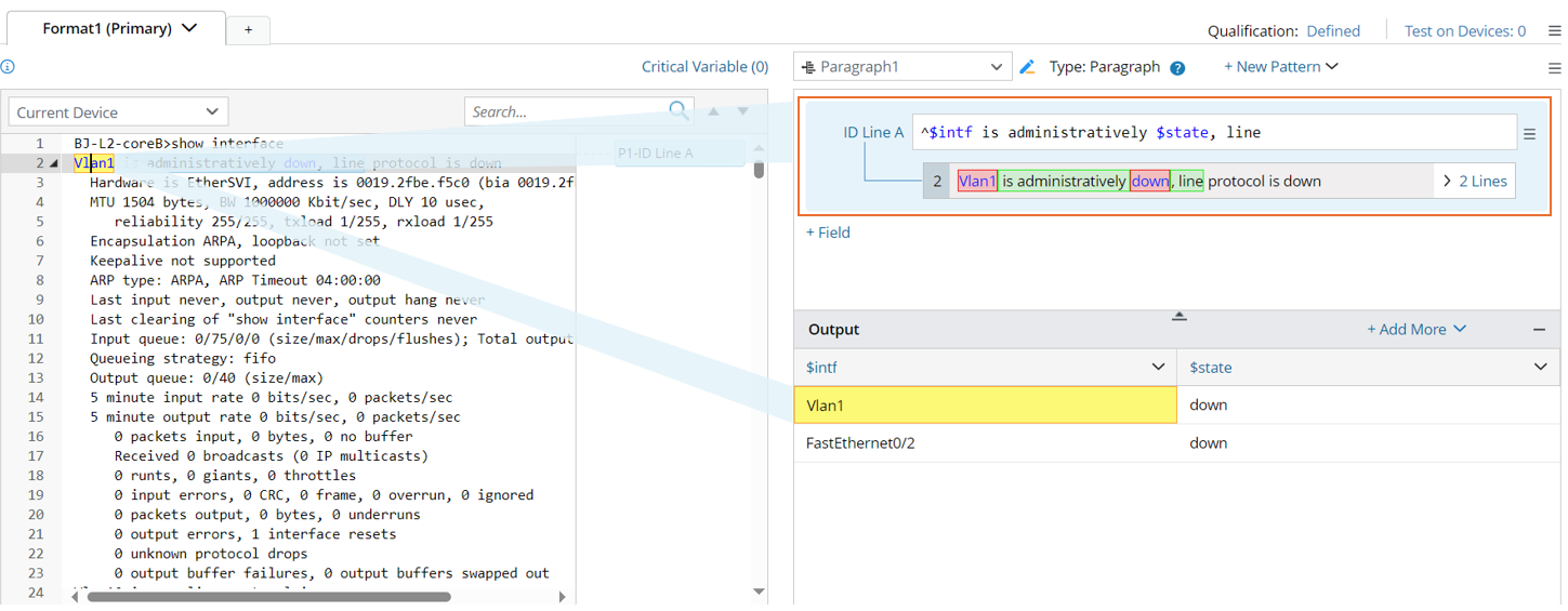

ID Line in Paragraph Parser
The default and mandatory ID Line is labeled as ID Line Pattern A, which divides lines of text into paragraphs. As shown below, the line of text that matches ID Line A’s line pattern is highlighted in each paragraph and labeled with numbers. The parsed values of variables are differentiated by the foreground color. When you click on a variable value in the parsed result, the value text will be highlighted in the sample text.

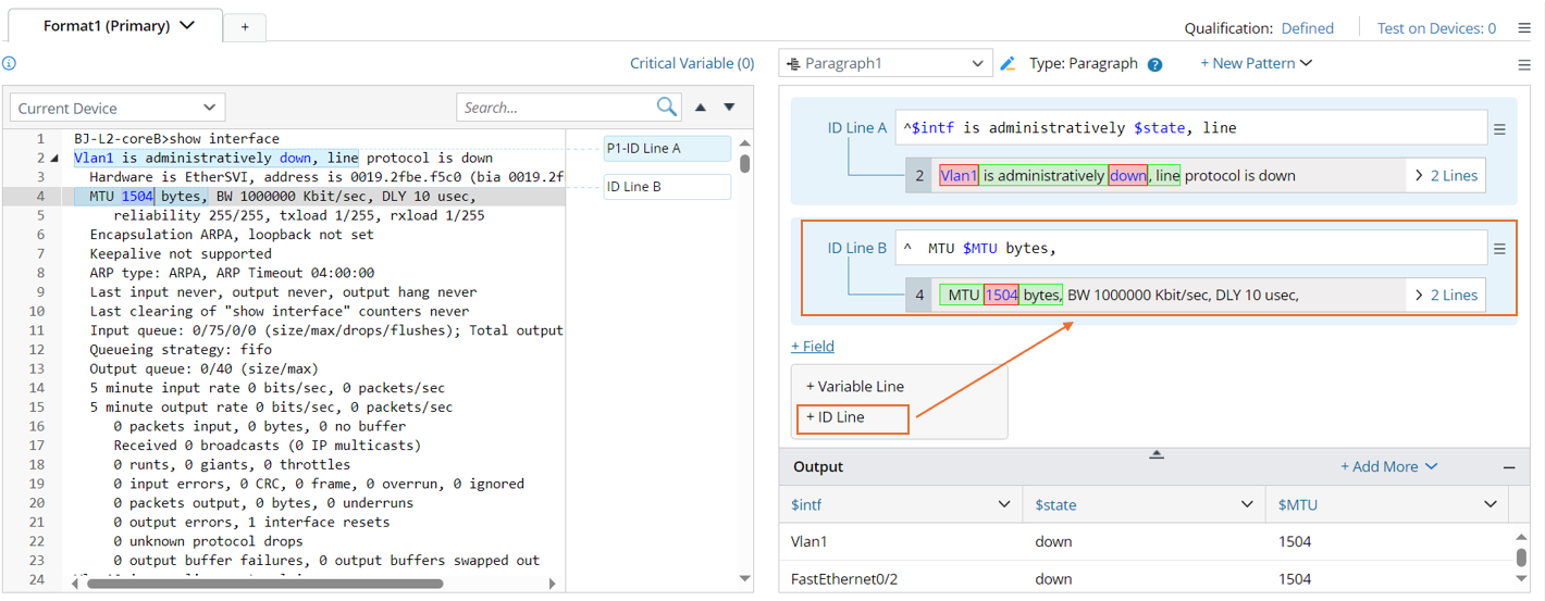

Beyond the ID Line Pattern A, you have options to add more ID Line Patterns B to Z to filter out unqualified paragraphs.
For example, the ID Line Pattern A of the following Paragraph Parser uses the interface name as the identifier to separate paragraphs, and the ID Line Pattern B further defines the condition that only the paragraphs for those interfaces, of which the MTU’s value is 1504 bytes, will be used for parsing. The lines of text that match the line pattern of ID Line B to Z are also highlighted and labeled. The labels for ID Line B to Z do not contain numbering because their numbers remain the same as the paragraph numbering of ID Line A.
