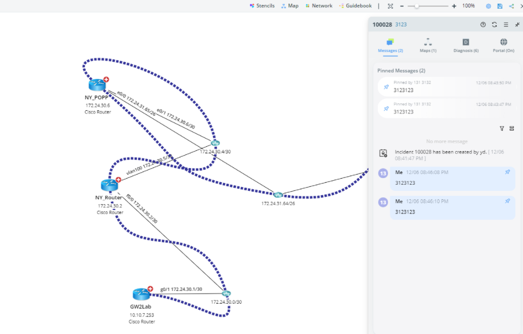

Troubleshooting with teammates collaboratively based on the automation findings via NetBrain map and portal.

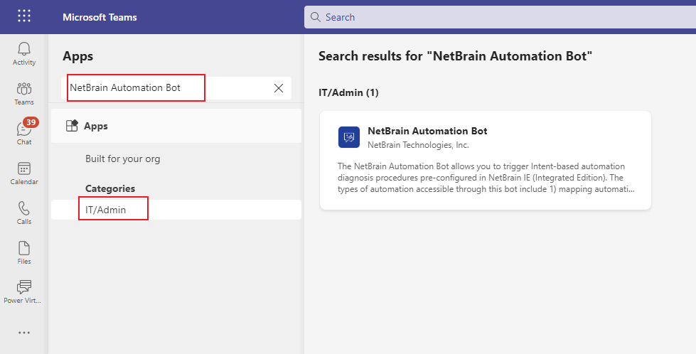

  1. Sign into Teams with your NetBrain account, e.g., [email protected]

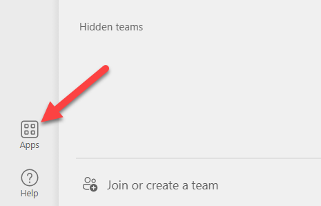

  2. Go to the Apps Store by clicking Apps on the lower left corner.

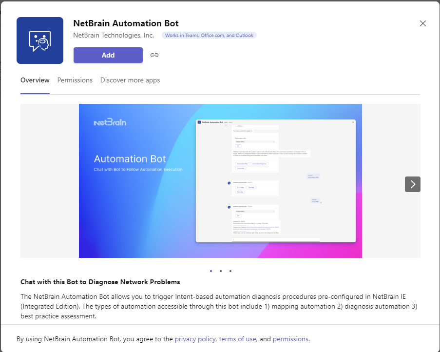

  3. In the Apps Store, search for NetBrain Automation Bot.
  4. Click Add.

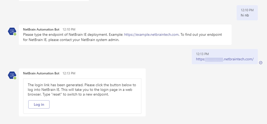

  1. To wake up the Bot, type" Hi NetBrain" or "hi nb".
    Information Tip: The commands in the Bot are NOT case sensitive.
  1. The Bot will prompt you to enter your NetBrain endpoint
    Information Tip: If you have difficulties finding the endpoint, please contact your NetBrain system admin.

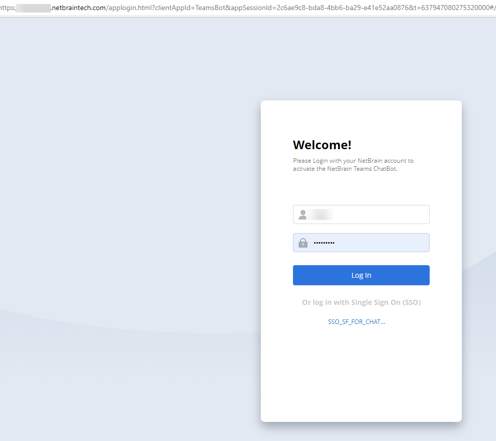

  1. Click Log in Button, and it will take you to the login page in a web browser.
  2. Input your NetBrain account credentials and click Log in.

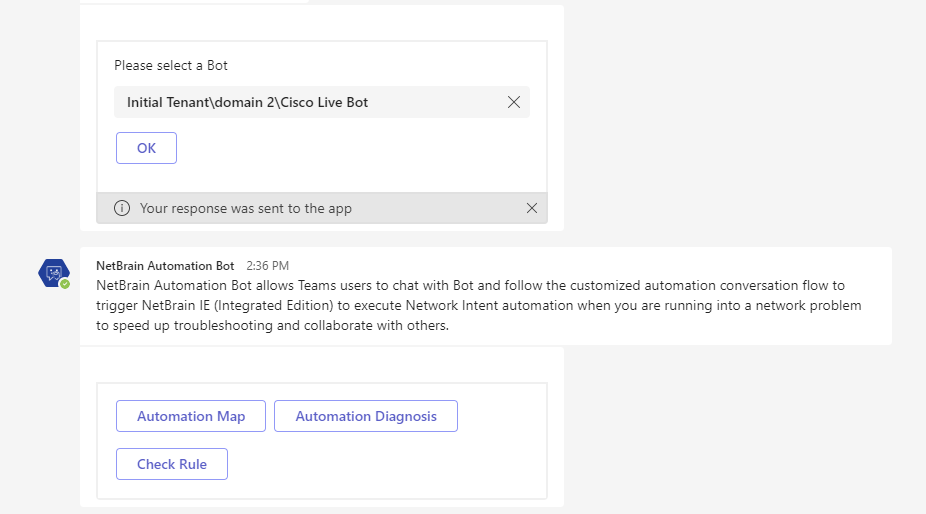

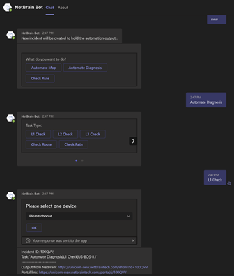

  3. After logging in successfully, you can select a Bot that was pre-customized in NetBrain to trigger automation diagnosis.
  4. Follow the link to open the NetBrain map or incident portal.
