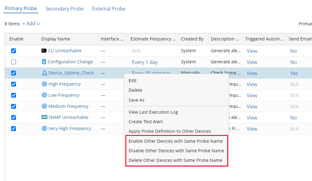

When a flash probe is enabled, it will trigger respective tasks to retrieve data and perform an error check periodically. If you want to enable/disable/delete the flash probe on multiple devices, right-click a flash probe and choose from the following options:
  • Enable Other Devices with the Same Probe Name
  • Disable Other Devices with the Same Probe Name
  • Delete Other Devices with the Same Probe Name
