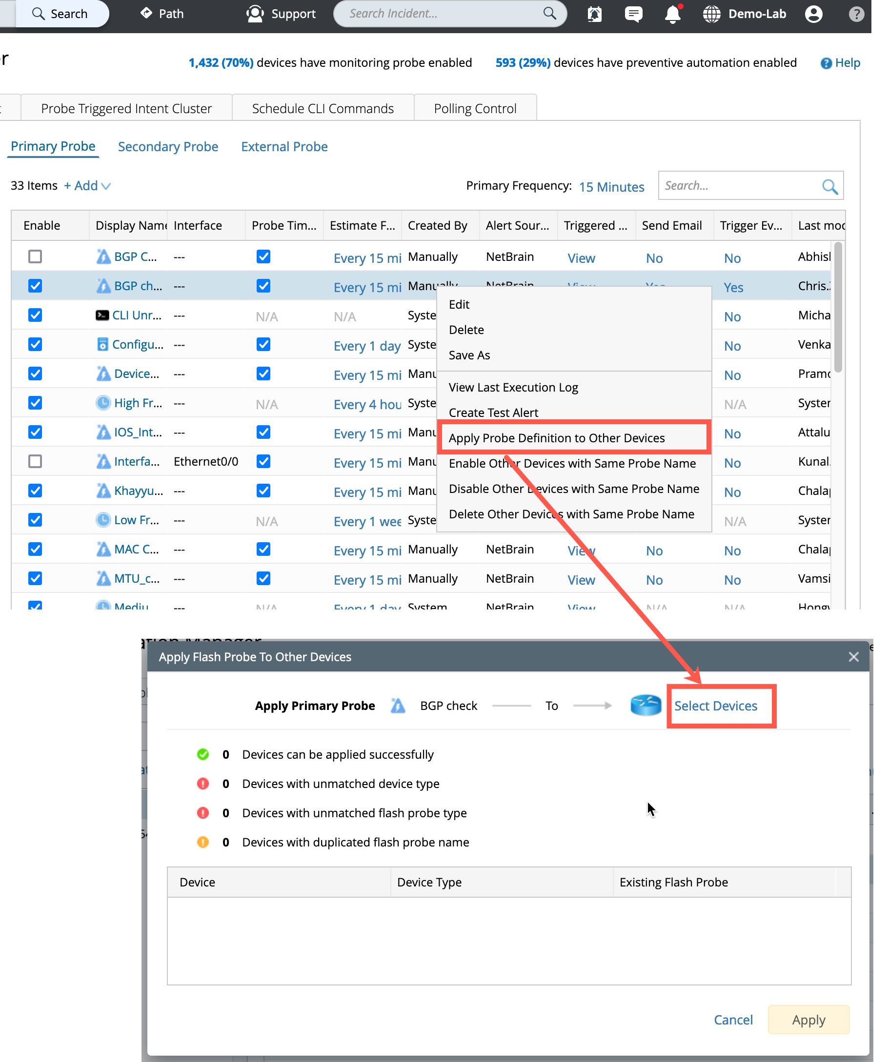

Apply the Primary Flash Probe to Other Devices
As mentioned above, the flash probe is created on a single device. However, it can be bulk applied to other devices.
A screenshot of a computerDescription automatically generated
The system will check whether the selected devices are valid for bulk application according to the logic below:
  • The parser of the existing flash probe can also be applied to the target devices. For example, if you use Cisco BGP Neighbor for the existing flash probe definition, you can apply the probe to other Cisco devices; or if the existing flash probe uses SNMP public MIB to get the device interface status, you can apply this flash probe to any other devices since the parser can be applied to all device types.
  • If the same flash probe is already configured on other devices, you can decide to overwrite all duplicate flash probes or keep them to suit your specific needs.
