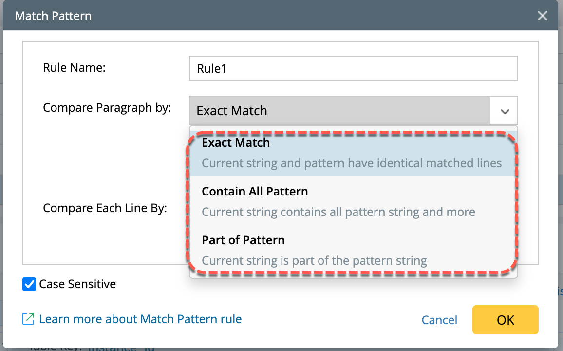

You can configure the control parameters of the current Match Pattern as follows.
  1. Rule Name: The rule name is generated automatically, and users can modify it.
  2. Compare Paragraph by: Compare each line of two paragraphs and calculate match results based on the selected options.
    • Exact Match: Current string and pattern have identical matched lines.
    • Contain All Pattern: Current string contains all pattern strings and more.
    • Part of Pattern: Current string is part of the pattern string.
  3. Ignore Order of lines: Whether to ignore the line order when matching.
  4. Compare Each Line by: Decide whether to exact match or not at line level.
  5. Case Sensitive: By default, this option is enabled to maintain compatibility with existing behavior.
  6. Click Learn more about... to see the match pattern rule, and then compare data with patterned text in baseline to know how to use the match pattern.

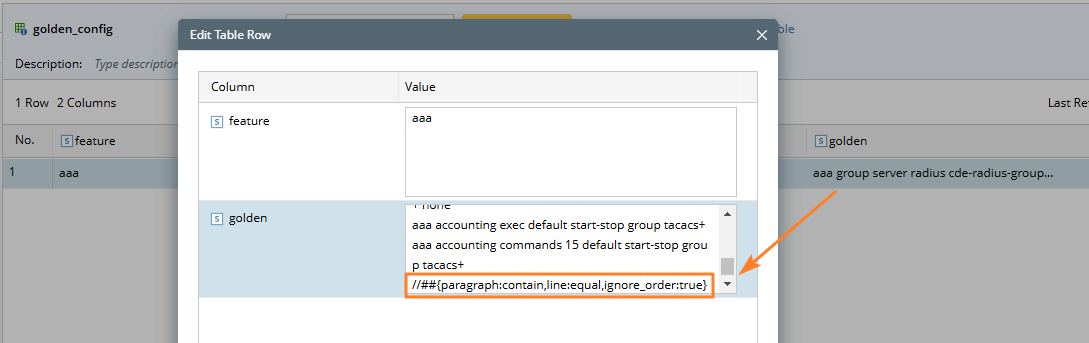

Please note that you can also directly define the match pattern rule in the pattern file by adding a control line at the end of the pattern line. Example: //##{paragraph:contain, line:equal,ignore_order:true}. The settings in pattern file is prior to the UI configurations:
Parameter Value
paragraph
  • match
  • contain
  • part_of
line
  • equal
  • contain
ignore_order
  • true
  • false
For Example: Edit a golden configuration with a control line in ADT.

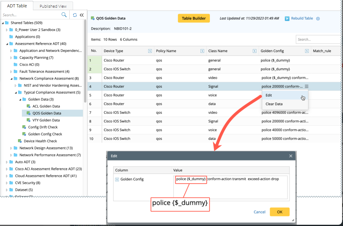

Example: Compare configlet data of the device US-BOS-R1 with the golden data (ADT: QOS Golden Data, column Golden Config).
  1. Go to the ADT QOS Golden Data in the Automation Data Table Manager.
  2. In the column Golden Config, edit the text replacing all the numbers next to police using {$var} (such as {$_dummy}).
  3. In the intent diagnosis, select the operator Match Pattern and define the match rule to recognize this format. The system will ignore this format according to the definition and determine whether the data matches.
