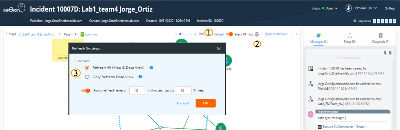

On the Map pane of the portal, you can set the frequency of refreshing Data View and define the maximum number of times to update Data View as needed.
  1. Turn on Refresh to enable refreshing the map and data view.
  2. Click the icon, then set the definitions in the pop-up dialog box.
    Information Note: The auto-refresh function will be turned off once the number of times of running auto-refresh reaches the upper limit.
  3. Click OK
