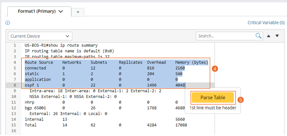

  4. In the Parser Input area, select lines 4-8.
  5. The floating tip window holding the Parse Table button will appear. Click the Parse Table button.
  6. The Table type will be selected, then you can continue to define the table parser. For detailed steps of defining a table parser, see Define a Table Parser
