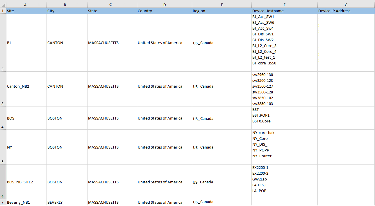

  1. Prepare a spreadsheet with the table headers to set the site hierarchy. Here is an example:
    Site Name (Office)\City\State\Country\Region\Device Hostname
    null
    Information Note: Only the .csv.xls, and .xlsx formats are supported. You can add more column headers or leave some columns blank based on your network distribution.
    Information Note: The site name cannot contain special characters, such as \ / : * ? " < > | . $
    Information Note: The values in the Device Hostname column must be the same as those in the domain so that the devices can be identified and added to the corresponding leaf sites.
    Information Note: The value in the Device IP Address column will be set as the criteria to search for site members. The IP addresses under the same site can be placed in the same row or in the same cell, and the IP addresses need to be separated by carriage return or semicolon. You can leave it blank if not required.

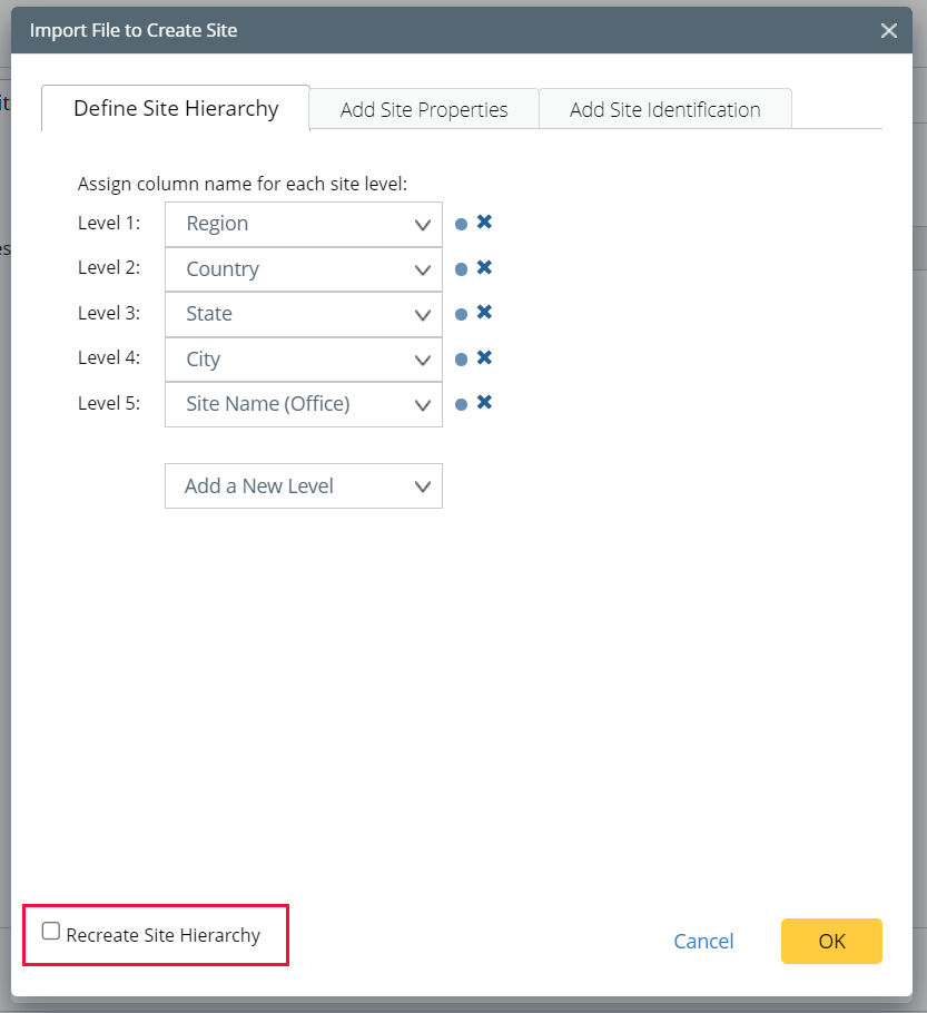

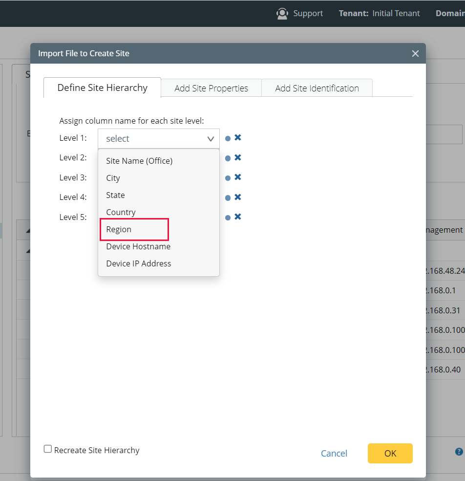

  4. Select corresponding levels to define Site Hierarchy. Level 1 is the highest level of a Site.

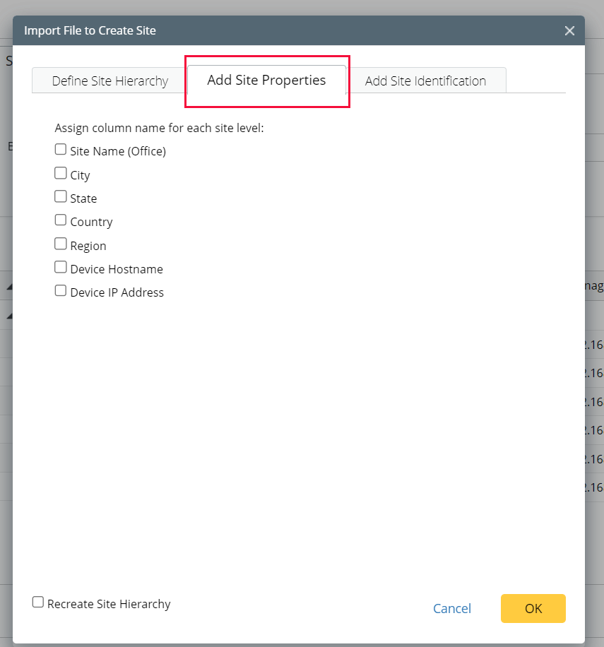

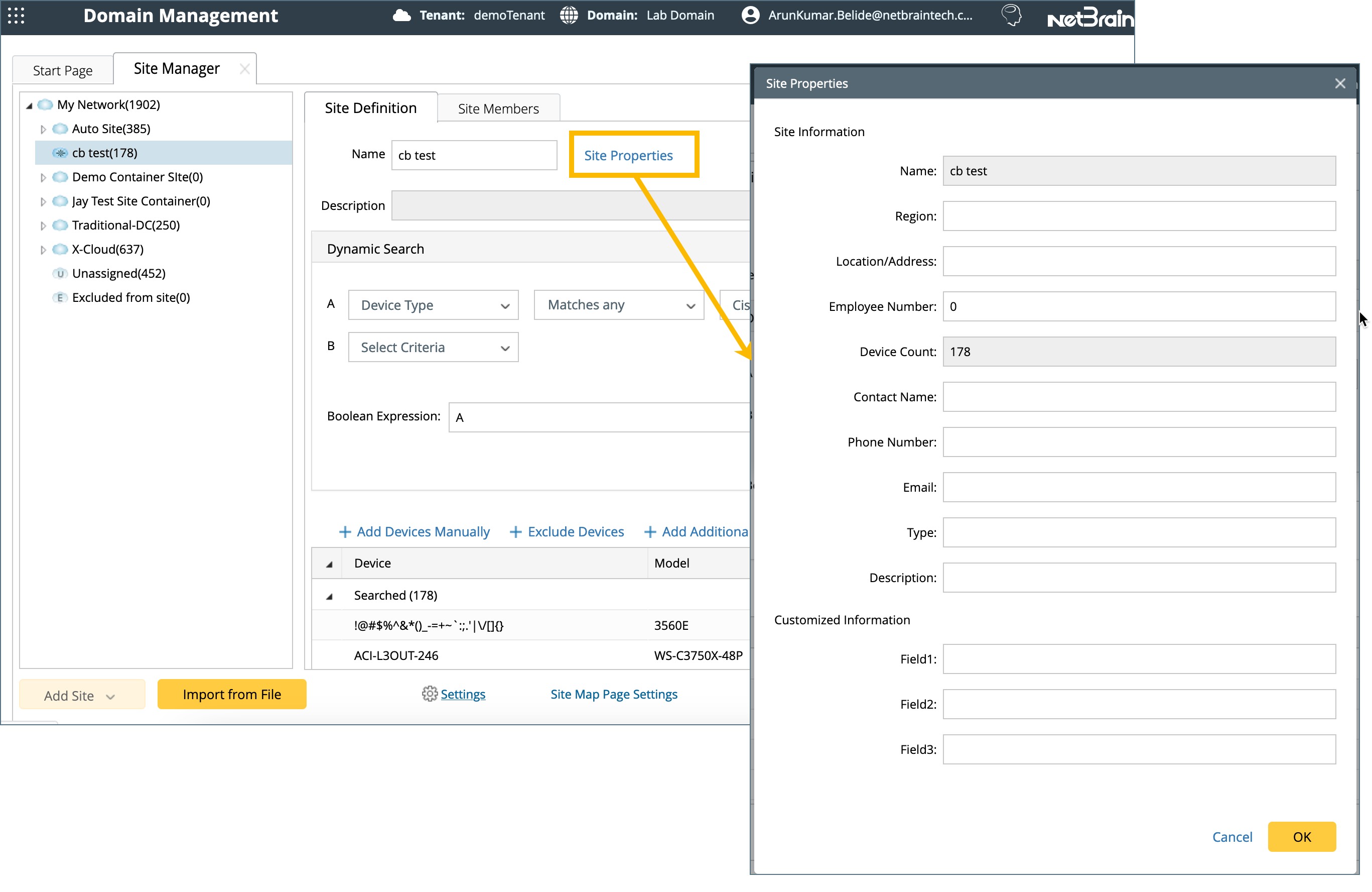

  5. You can also add specific columns as Site properties.
    Information Tip: The columns you checked will show up in the Site Properties window

  7. If you want to overwrite the current My Network hierarchy, you can check Recreate Site Hierarchy. This option will recreate My Network using the new hierarchy you defined in Define Site Hierarchy.
    Graphical user interface, table  Description automatically generated
  8. Click  to confirm importing the file as a Site.

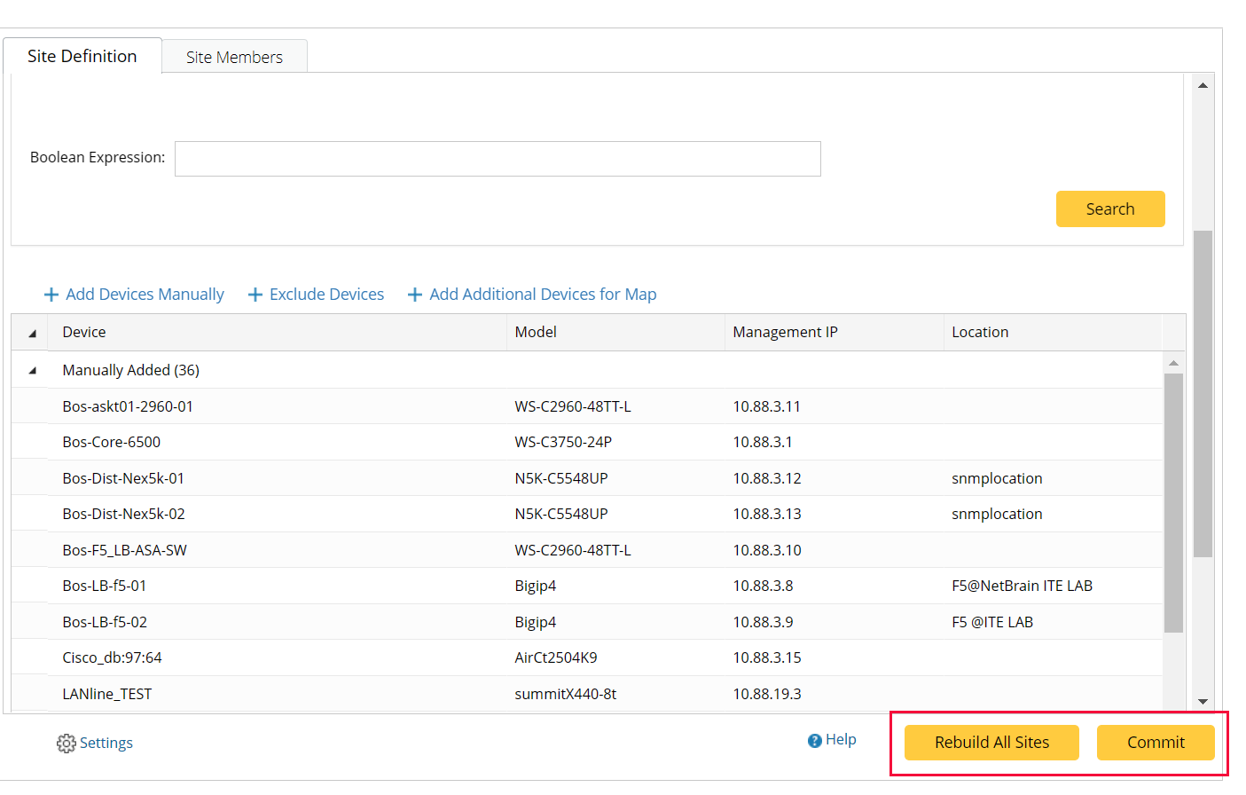

  9. Do not forget to Rebuild All Sites and Commit the changes.
