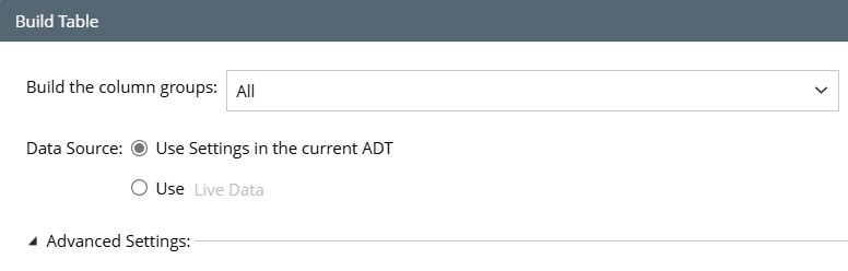

  5. Click Save and Build. The Build Table dialog appears, define the settings as per your preference to build the ADT data.
