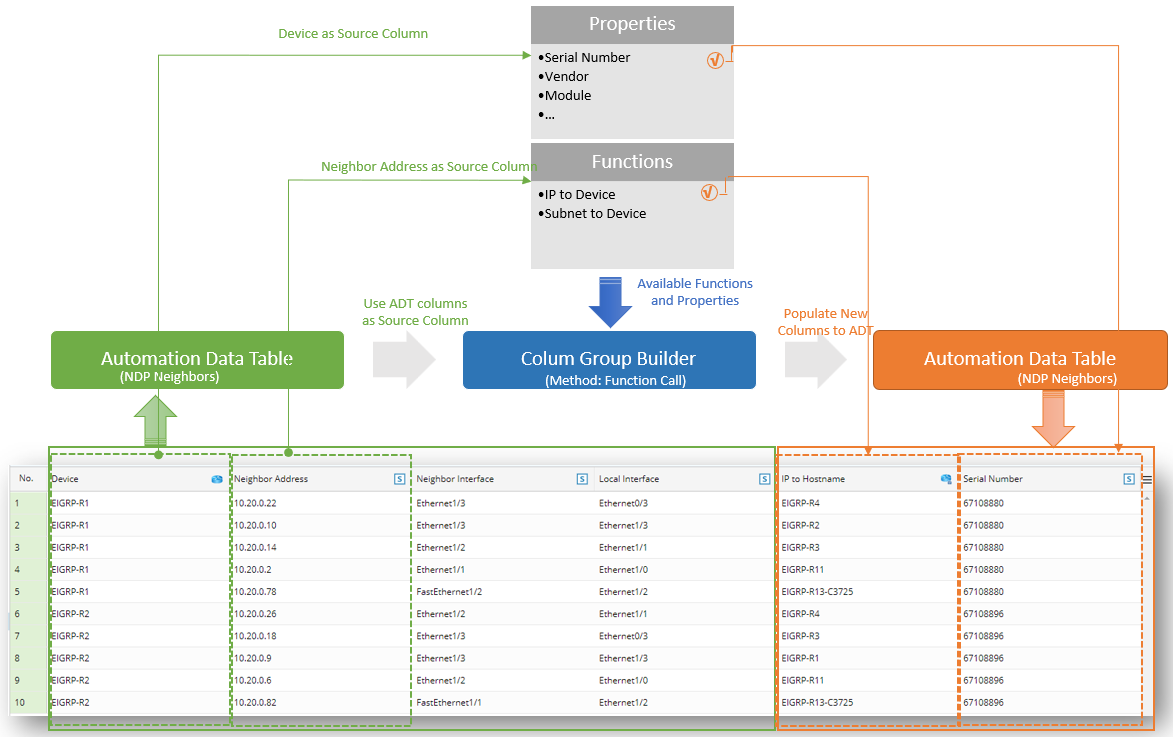

This chapter will introduce two method of building column group with formula:
The follow diagram illustrates how Function works in Column Group Builder:
TimelineDescription automatically generated
