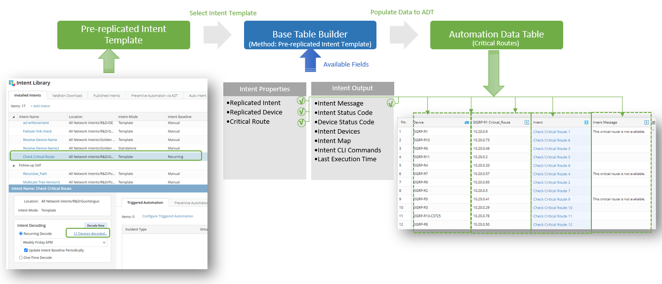

Select a pre-decoded intent template to build a device-based Automation Data Table. Based on the intent template decoding results, each replicated device will be populated as a table row. The replicated intent and the related Signature variable values of this device are shown in the corresponding table columns of this device row.

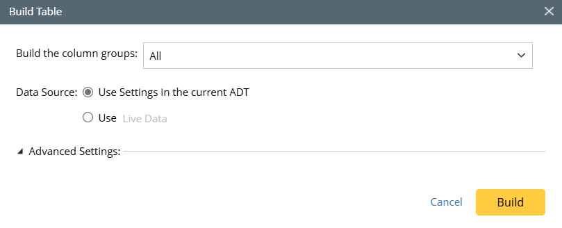

  1. Click Save to save all the settings.
  2. Click Save and Build to save the settings and build the ADT.
The following table describes available data fields for building base table if the intent template is the data source.
Table1 - Data Fields for Building Base Table Via Device of Pre-decoded Intent Template
Field TypeFieldsDescription
Built-in Field
Device
Intent
The built-in fields are created from the data used for intent template definition.
Device Signature Variable
Dynamic fieldsDynamic change based on the selected intent template.
Intent Data Field
Intent Message
Intent Status Code
Device Status Code
Status Code Summary
Result Summary
Intent Devices
Intent Map
Intent CLI Commands
Last Execution Time
The intent data fields are created from intent details of the intents generated from the intent template.
CSV
CSV Columns
If the selected intent template has CSV outputs, the CSV columns can serve as available field.
