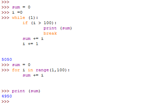

The following example introduces two methods to calculate the sum value from 1 to 100:
The second method uses the range statement and generates a different result from the first method. This is a common error in the range statement. Because range(1,100) means that "i" will loop from 1 to 99, and stop on 100.

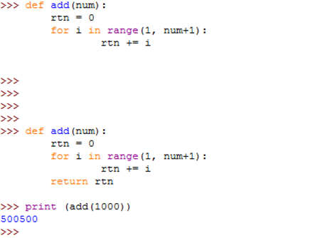

If you want to calculate the sum value from 1 to 1000, you have to modify the code lines in the proceeding example accordingly to meet the requirement. To better reuse the code, you can define a function as follows:
  1. Use the keyword def to declare a function definition, and then type the function name and the parenthesized list of formal parameters.
  2. Enter the statement of the function at the next line with indented.
  3. Use the return function to return the result. The return function returns Null if no expression arguments are specified or the function fails for some reasons. This is different from other languages where the return function is necessary to exit a function.
  4. Use the print function to print the result.
