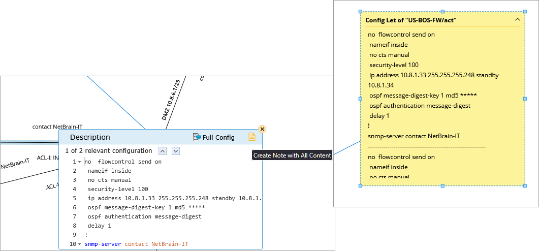

Follow the steps below to add a device note from a map:
  1. On a Map, open the Design Reader for the data unit you want to annotate.
  2. Select one or more lines in the configuration, and then click the  icon.
    Information Tip: To create a note for the entire content in the Design Reader, click the icon without selecting any lines.
  3. To create notes for more configurations, click Full Config in the design reader and repeat the steps above.

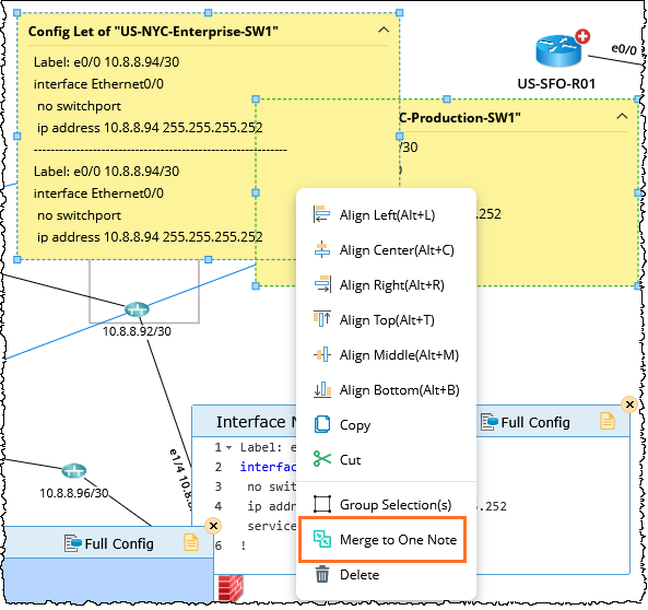

    Information Tip: To merge multiple notes, select the notes, right-click the blank area, and then select Merge to One Note from the drop-down menu.
