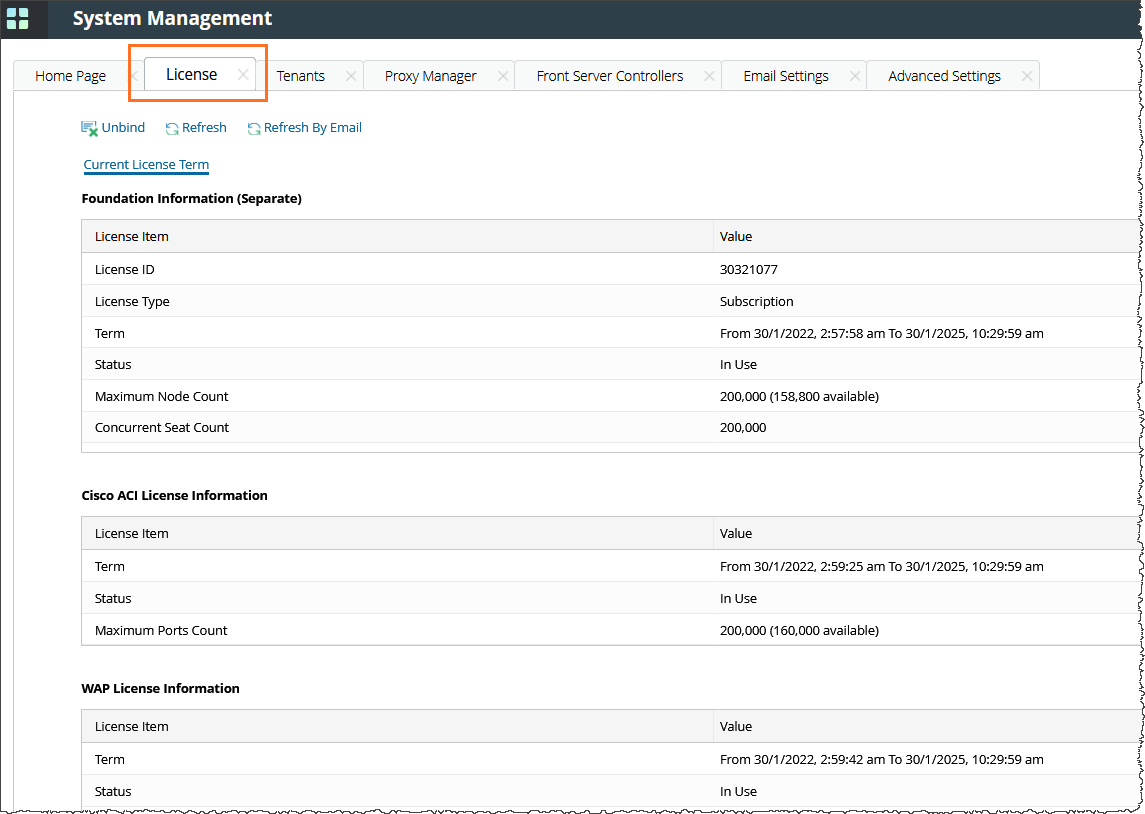

  5. To browse license information, navigate to License > Current License Term.

  6. To browse the license information, navigate to License, and check the license information under Current License Term. See License Information for more details.
License Information
The following table includes the information about your activated license.
ItemDescription
License ID
(Foundation License only)
The unique identifier for the license that you have activated.
License Type
The type of license that you have activated.
TermThe validity period of your license.
StatusThe usage status of your current license.
Maximum Nodes Count
(Foundation/WAP/CM/AAM/IBA License)
The maximum device nodes that you can discover and manage in the system.
Maximum CPU Sockets Count
(vCenter/NSX-v License/NSX-T License)
The maximum number of physical CPUs of the ESXi host or the ESXi host running NSX-V.
Maximum Ports Count
(ACI License only)
The maximum number of Cisco ACI downstream ports on Leaf and FEX.
Maximum VPC Equiv Count
(Amazon AWS License and Google Cloud Platform License)
The maximum number of VPC Equiv managed by the account.
Maximum VNet Equiv Count
(Microsoft Azure License only)
The maximum number of  VNet Equiv managed by the account.
Concurrent Seat Count
The maximum user accounts that can log in to the system concurrently.
Information Note: The Next License Term tab will only become available if you’ve purchased a license with a future starting date. The available licenses will be updated with the emergence of new tech.
