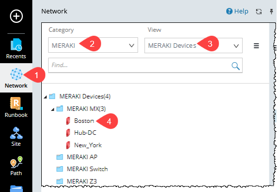

Follow the steps to view the details of a node.
- In the NetworkBrain desktop sidebar, open Network.
- In the Network pane, select MERAKI in the Category field.
- In the View field, select MERAKI Devices.
- Expand the MERAKI Devices node to view more information.
Tip: The number next to each node indicates the number of its child nodes.

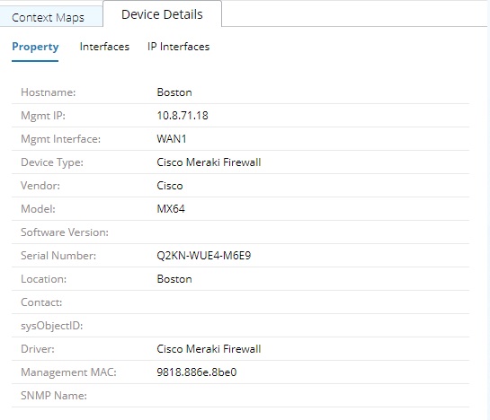

- Select a node and click Device Details pane to view the node’s detailed property, interface and IP interfaces.
