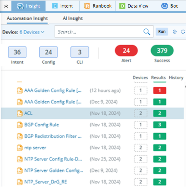

The Automation Insight tab organizes the golden configs by rule, with each row displaying one rule. Each rule might contain multiple devices.

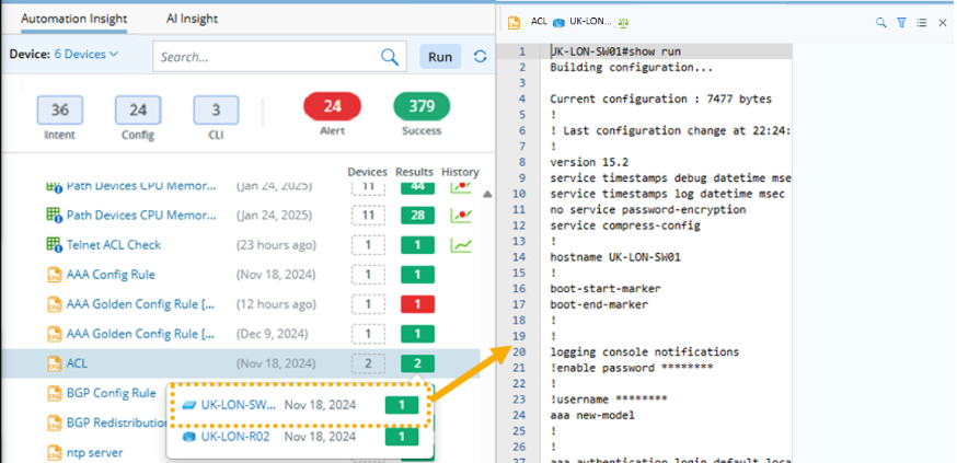

Example: View the ACL golden config.
  • The name of the golden config is ACL.
  • The last execution time was Nov 18, 2024. When there are multiple devices, it displays the latest update time.

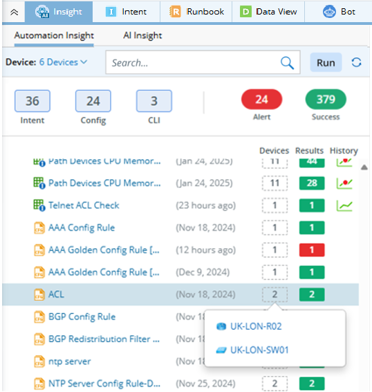

  • Devices. The device number in the golden config was 2. Click 2 to view the devices.
  • Results. The compliance count in the last result was 2.
    • Click 2 to open the tooltip and see the compliance results.
    • Click the result to open the detail pane. In the detail pane, you can switch between devices.
