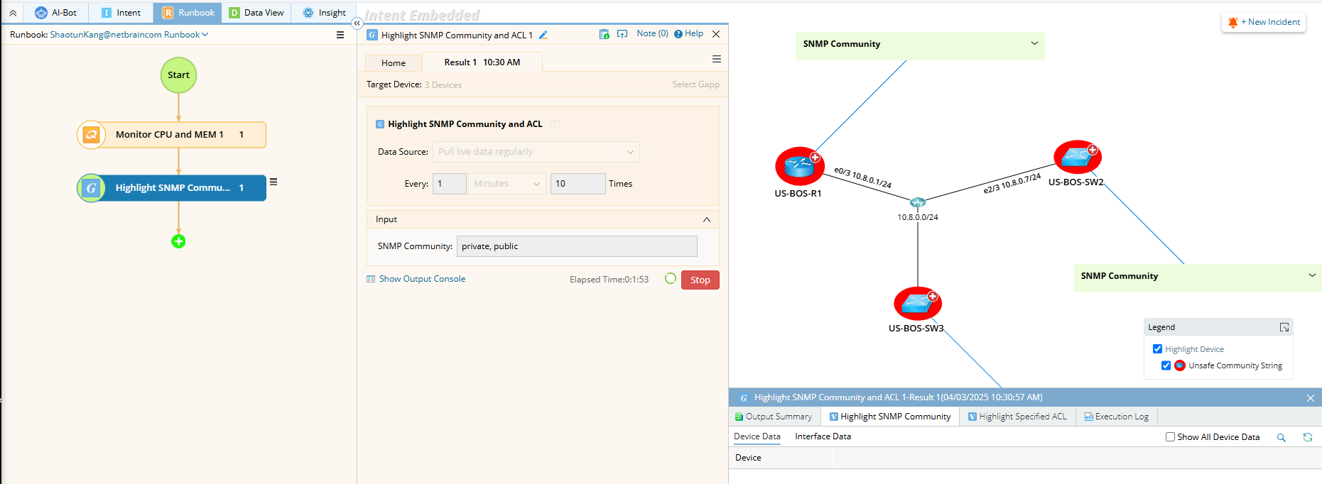

  1. Map the target devices.
  2. On the map page, right-click on the blank area and select Run Gapp from the menu.
  3. Select the Gapp you have created, and then click OK.
  4. In the opened Runbook pane, set the data source and threshold. In this case, select Pull live data regularly as the data source and set frequency as every 1 minute, which means that the system retrieves live data from devices and refreshes the corresponding values every 1 minute. For the demo purpose, modify the default threshold value to 1.
  5. Click Run in the Runbook pane.
