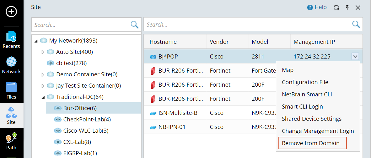

  1. Remove the device from Site pane
    1. Click Site on the taskbar.
    2. Right-click the target device and select Remove from Domain from the drop-down list.

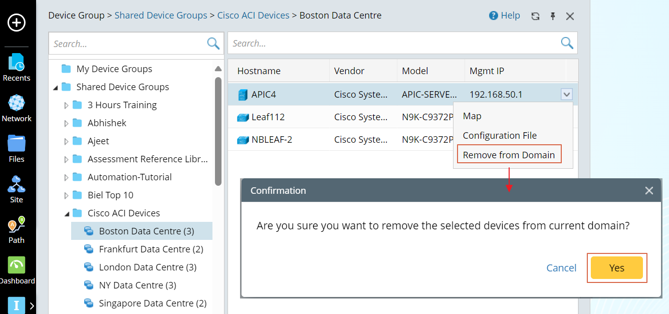

  2. Remove the device from Device Group
    1. Click the target device group and all the devices in this group are displayed in the left pane.
    2. Right-click the target device and select Remove From Domain from the drop-down list.
    3. In the pop-up dialog. Click Yes.
      Note: You can also right-click the target device group and select Delete to delete the device group.
      Tip: The devices in the System folder cannot be removed in this way.

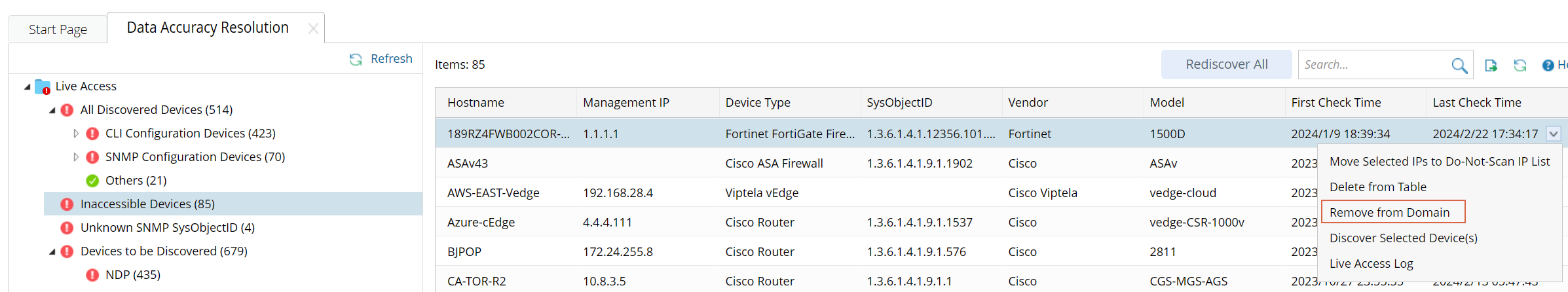

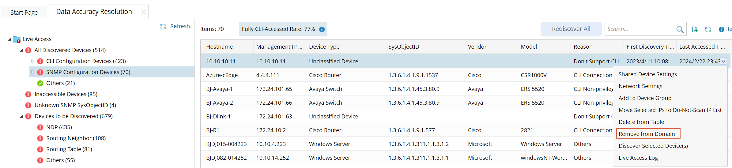

  3. Remove device from Data Accuracy Resolution
    1. Log into Domain Management page.
    2. In the Domain Management page, click Data Model > Data Accuracy Resolution from the quick access toolbar.
    3. On the Data Accuracy Resolution tab, there are two ways to remove a device:
      1. Click Inaccessible Devices, and right-click the target device in the table and select Remove from Domain.
      2. Click SNMP Configuration Devices, and right-click the target device in the table and select Remove from Domain.
