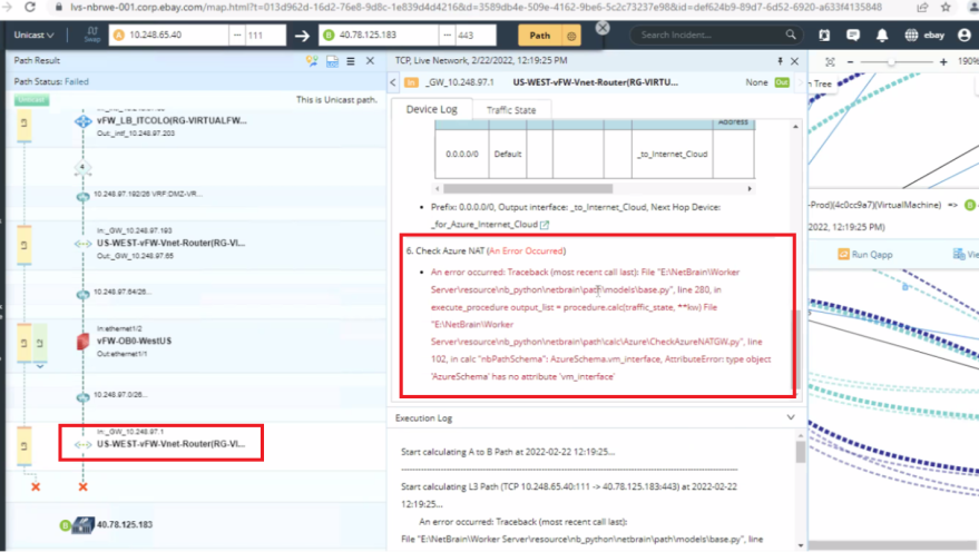

Error Code: PF-007-001
Description
If the path failed, check the node/device which causes the failure and find the cause message in path log details. If you see Error message such as "An error occurred", follow the instructions below.

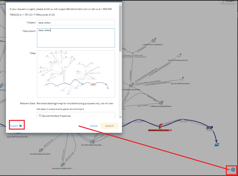

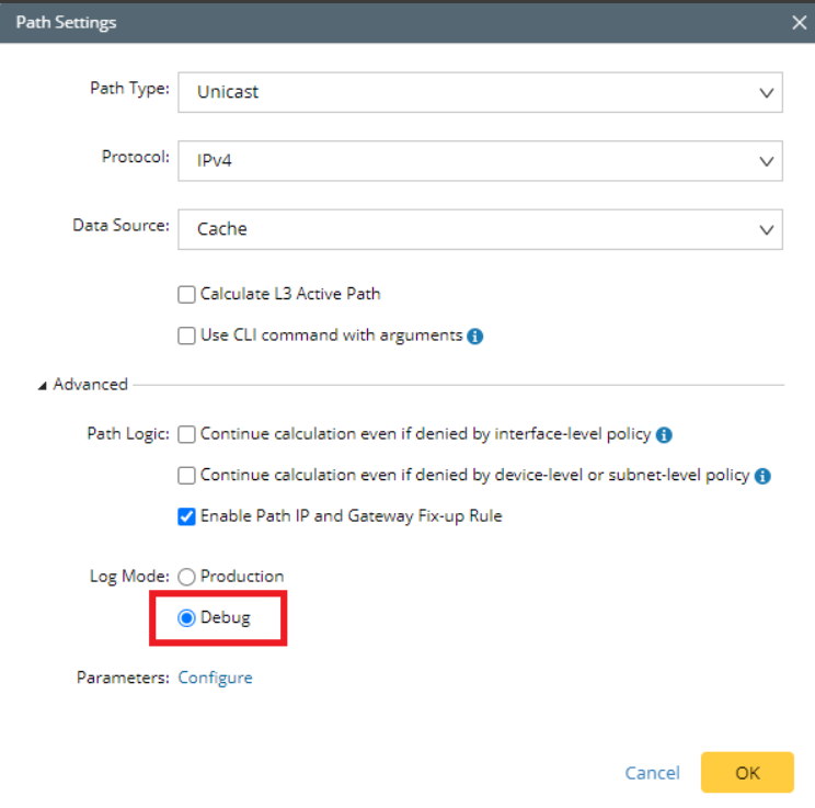

    • Enable the path debug mode.
    • Export Map by clicking Contact NetBrain to export the node data. Remember to draw all the nodes/devices involved in the path on the map and expand all their neighbors before exporting the map.

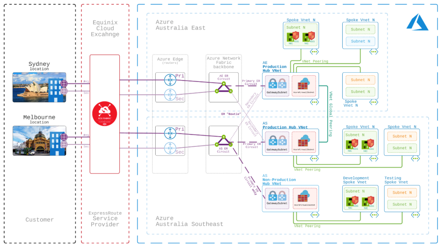

  • Customer Network Figure: Ask customer to feedback the network design figure that can show the path flow.
