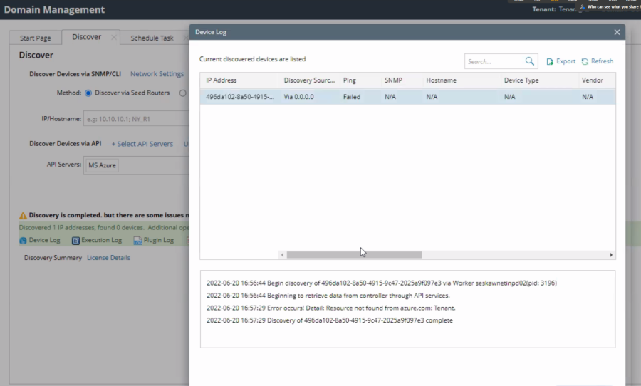

Description
Test might be successful (upgrading the version could resolve the inconsistency issue) while discovery failed and you will see "Error occurs! Detail: Resource not found from azure.com: Tenant" in the Device Log, which means the first API during discovery to fetch resource failed.
