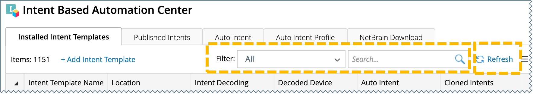

In the Installed Intent Templates pane, the following basic operations are supported:
  • Refresh NITs in the table: Click Refresh to refresh the intent templates listed in the Installed Intents Templates pane.
  • Search NITs: Search for intents by entering search keywords (eligible search keywords are group name, intent template name, location, and intent decoding) in the search bar to find desired intents.

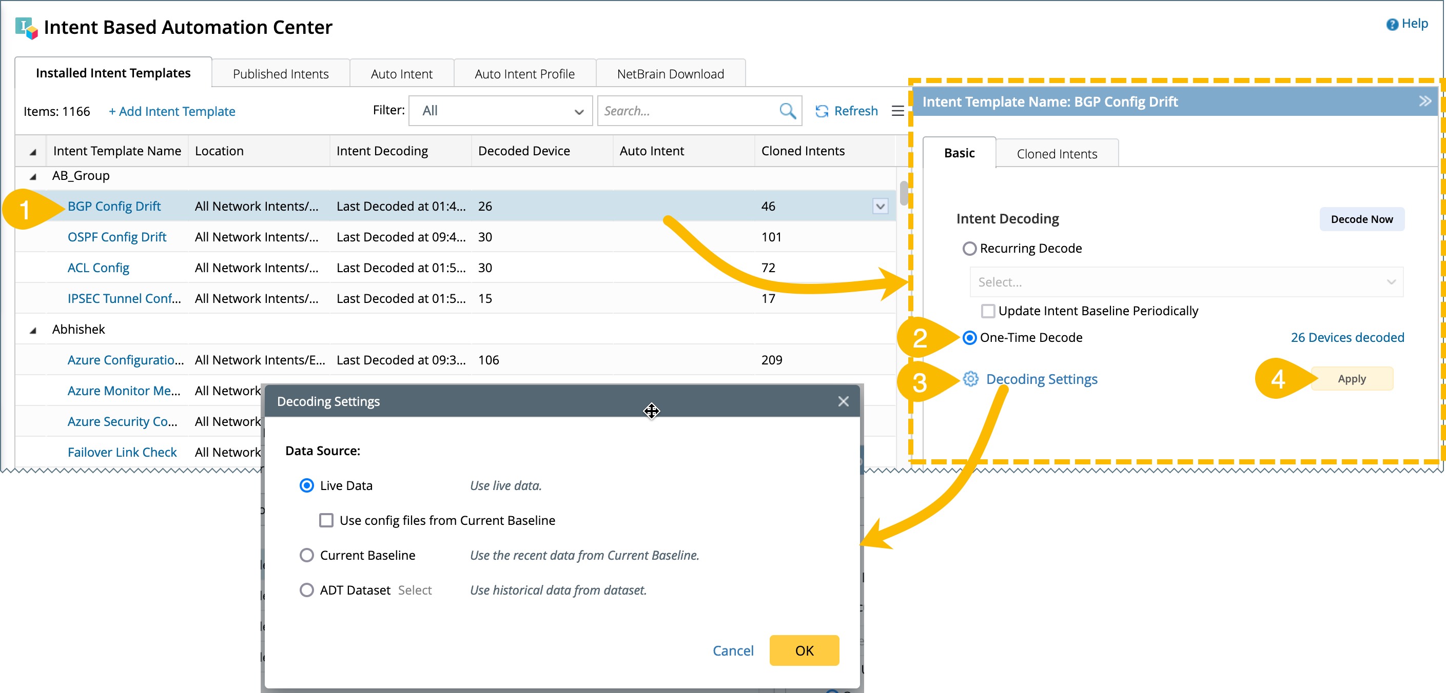

  • Define decoding settings for NIT:
    1. Select an NIT from the left pane,
    2. In the right side pane , choose an intent decoding mode.
    3. Select the data source in the Decoding Settings and click OK.
    4. Click Apply to save the settings.

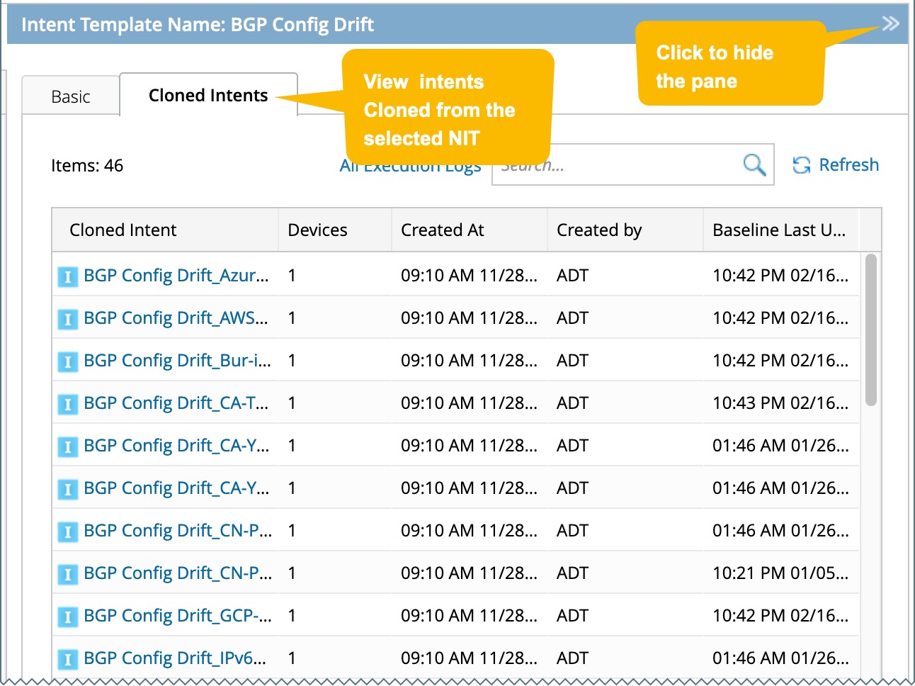

      Information Note: In the Cloned Intents tab, you can v iew the intents cloned from the selected NIT.
      Information Note: You can hide and unhide the right pane by clicking  at the upper-right corner.

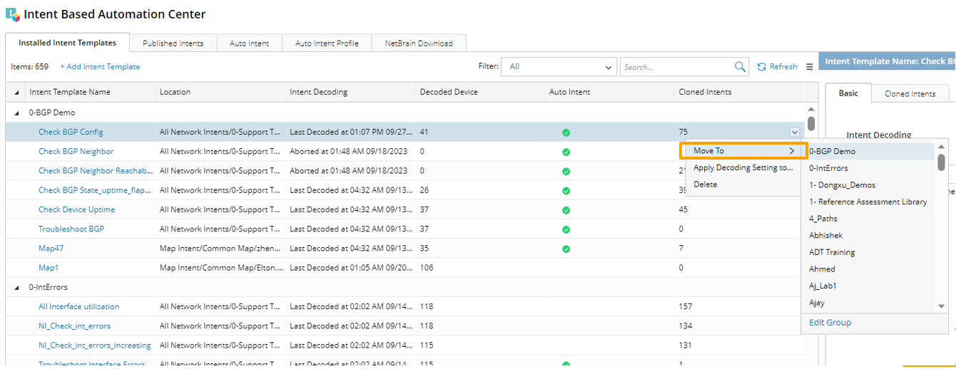

  • Move NITs: Click Move To from the drop-down menu of an intent item and select a group from the folder list to the right to move the intent to another group.

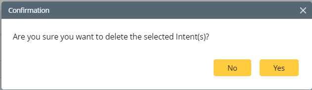

  • Delete NITs: Select Delete from the drop-down menu of an intent item to delete the intent.
    A message will pop up to ask you to confirm the delete operation.
    After this operation:
    • The selected intent item is removed from the IBA Center. This operation does not delete the intent itself (you can delete an intent from the Intent Manager).
    • The tasks related to the deleted intent in the decoding engine and baseline engine are removed.
    • The deleted intent will not be displayed in the Auto Intent pane on a map.

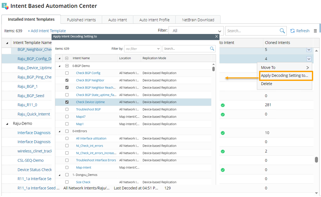

  • Apply Intent Decode Setting to: Click Apply Intent Decode Setting to from the drop-down menu of an NIT, select some NITs to apply the decoding settings of the current NIT to the selected NITs.
