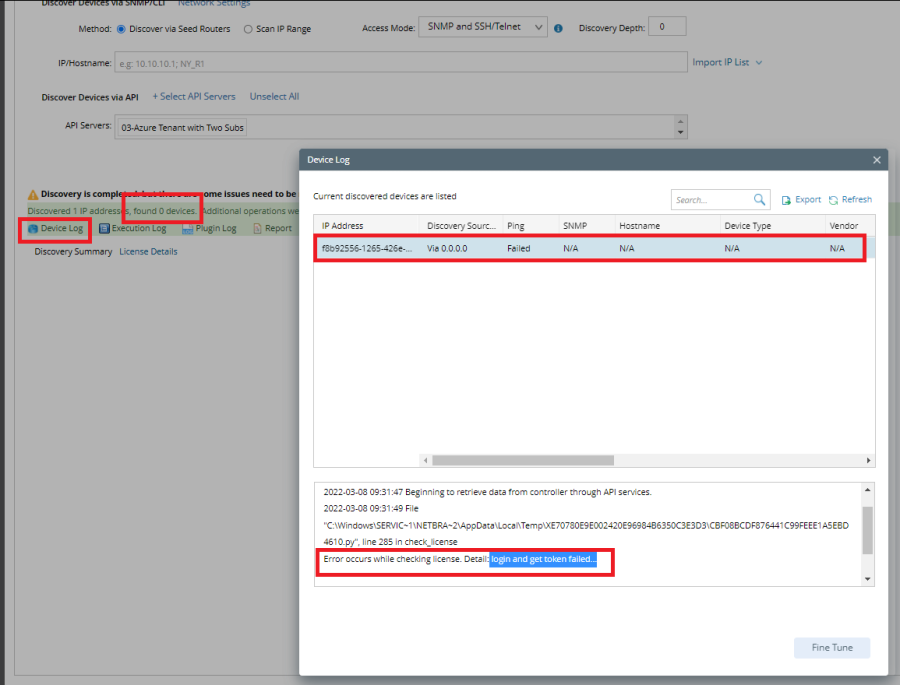

If no device can be found after discovery, review the Device Log and find the message such as "login and get token failed", then follow the instructions below.
Troubleshoot

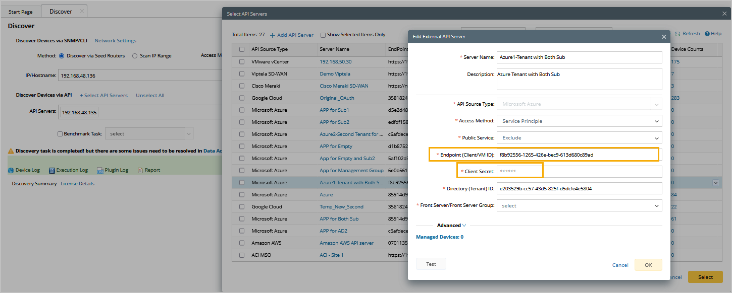

  1. Normally the root cause for this error is that the API secret configured in NetworkBrain is expired. Create a new one from the customer’s Azure portal and update it into NetworkBrain API Server.
  1. Create a new client secrete for the specific client which can be identified by client ID.
  2. After updating the client secret in NetworkBrain API Server, click Test to confirm whether the issue has been fixed.
