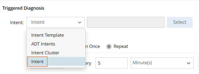

  1. In the Intent field, click the icon, then select Intent from the drop-down list.
  2. Click Select. In the Select Intent dialog, enter search keyword to find the proper intent, then select the intent Slow Application
    Information Note: Selecting the two options Show Intents Serving as Template Only and Show Published Intents Only will help to narrow the scope of intents listed in this dialog.
  3. Click OK

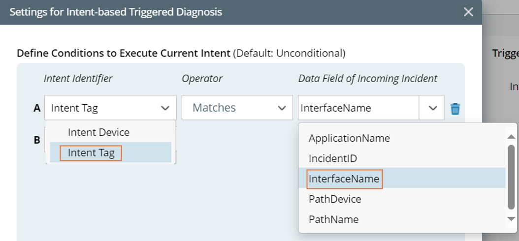

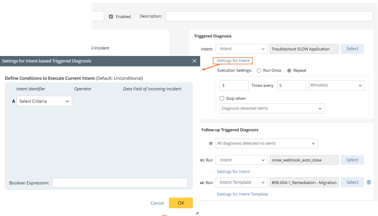

  1. After selecting an intent, the Settings for Intent-based Triggered Diagnosis dialog will pop out, and you can make relevant settings. You can also click Settings for Intent to open this dialog.
  2. Define Conditions to Execute Current Intent: In the Settings for Intent-based Triggered Diagnosis dialog, define one or more conditions for triggering the diagnosis by matching the intent properties with the data fields in the incident type used for this triggered diagnosis.
  • Select Intent Identifier: Select the identifiers for the Intent, Intent Device or Intent tag for matching.

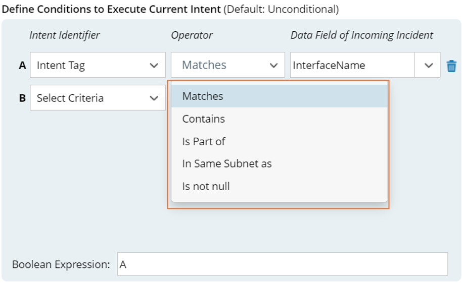

  • Select Operator: Select a matching logic, for example Matches. The system provides several operations for defining condition as shown below.
  • Select Data Field of Incoming Incident: Click , then select a data field of the incident type for matching the intent from the drop-down list.
    You can repeat this step to add more conditions (B, C, ...).
  • Define Boolean Expression: The system will automatically input the Boolean Expression (if only one condition is defined, it will be "A"; if multiple conditions are defined, it will be like "A and B").

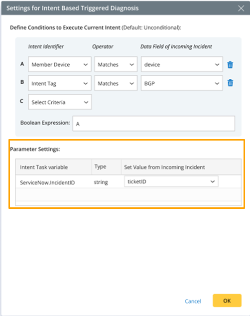

  1. Define Parameter SettingsTask variables can serve to pass information about third-party system (for example, ServiceNow incident ID) from home intent to any follow-up intents. To define the task variable, click  from the Set Value from Incoming Incident field and select an incoming incident value (for example, ticketID) as the task variable value.
    Information Note: The Parameter Settings block is only visible when the intent has task variables defined.
  2. Click OK in this dialog to save the settings and close the dialog.
