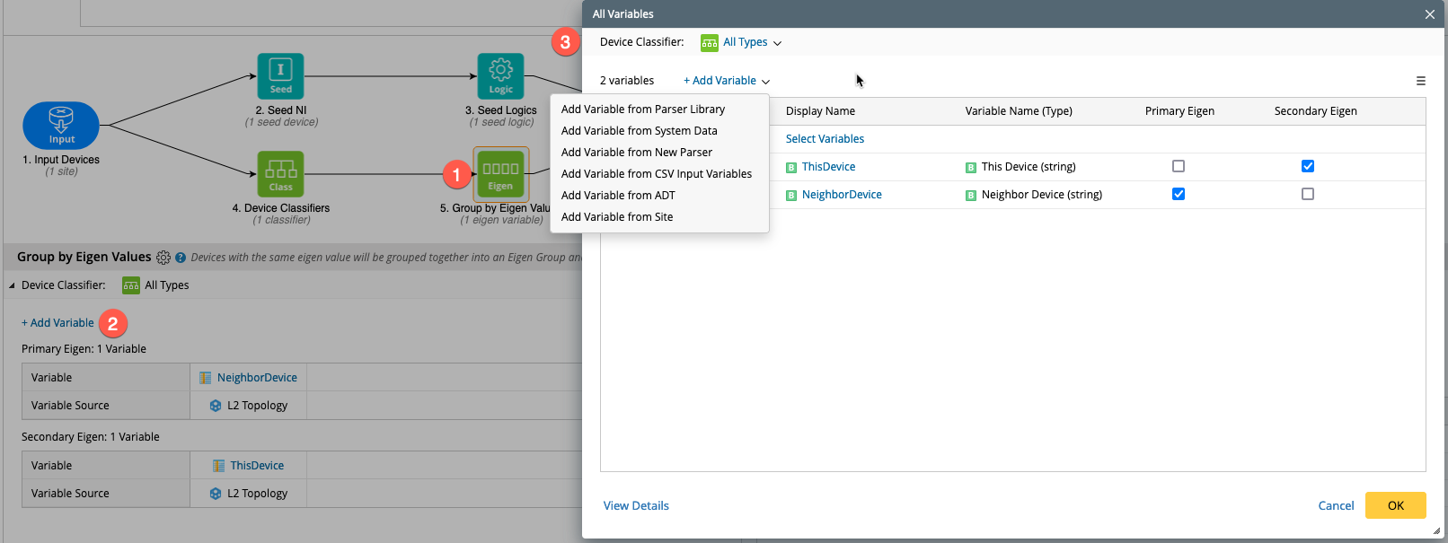

Click Group by Eigen Values, then click on + Add Variable.
- In the All Variables window, click Add Variable. You can add variables from:
- Existing parsers in Parser Library
System data:
- Device property
- Interface property
- Topology data
- VLAN group
Subnet
- New parser
- CSV input variables.

- Click Group by Eigen Values, then click + Add Variables.
- In the All Variables Window, click + Add Variables and select Add Variable from System Data.
Select L3 Topology from the drop-down list and select all of the four variables.

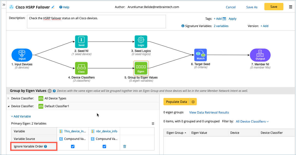

Click
and select Add Compound Variable.
Define the string variable This_device_info with the definition $thisDevice + $localInteface.
Also, you can create the compound variable $neigbor_device_info with the definition $neighborDevice + $neighborInterface.
NetworkBrain will create two eigen groups for a pair of this_device_info and neigbor_device_info as (R1e0, R2e0) and (R2e0, R1e0).
If the order is not important and only one Eigen Group needs to be created, you can ignore variable orders by checking the Ignore Variable Order option.

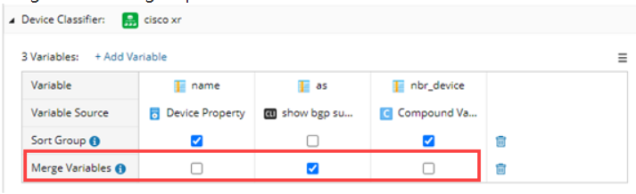

By default, NetworkBrain will group the devices with the same Eigen Value. In some cases, you may want to group devices even if some Eigen Values are different.
Example: To check the neighbor relationship between P and PE devices, the P device and its PE devices need to be added to the same Eigen Group.
- Add four Eigen Variables: $name, $BGP_as_number, $nbr_device, $local_IP.
Ignore the order of $name and $nbr_device by checking Ignore Variable Order option.

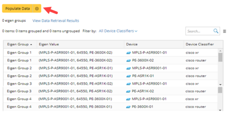

Click Populate Data to generate four Eigen Groups for each pair of P and PE neighbors.

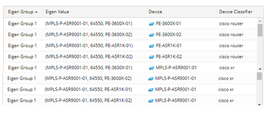

Enable the merge variables option and select the variable as , so that the devices with the same as number will be merged into one group.
Click Populate Data again, the four Eigen Groups will become one group.
