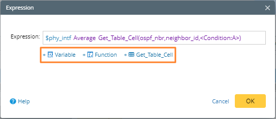

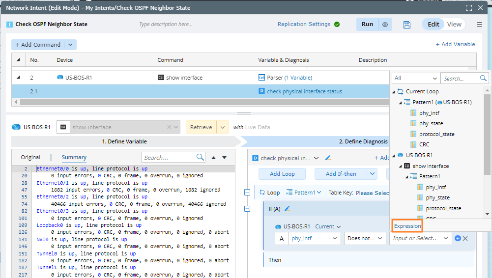

  1. Click Expression.
  2. Define the variable and expression.
    1. Click + Variable to select the variable that needs to be referenced in the expression.
    2. Click + Function to select the definition expression of the variable.
      NoteYou can call a built-in function or do a simple math operation (+-*, and /), such as $var1 + $var2.

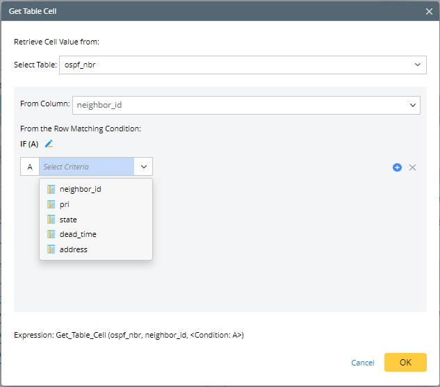

    3. Click + Get_Table_Cell to define where the cell value comes from.

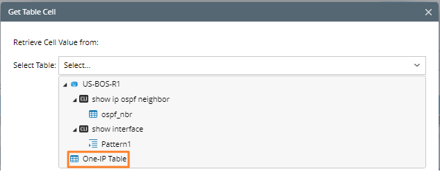

      Information Note: The cell value can also come from One-IP Table.

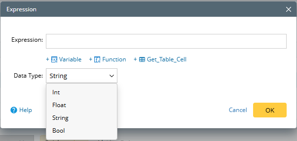

    4. If you define the expression from the left side, you need to select the variable type to determine the operator.

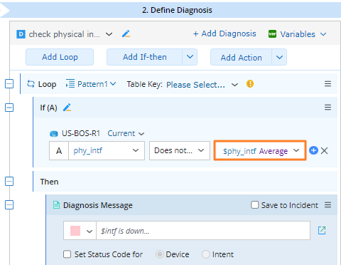

  3. View the defined expression in the diagnosis.
