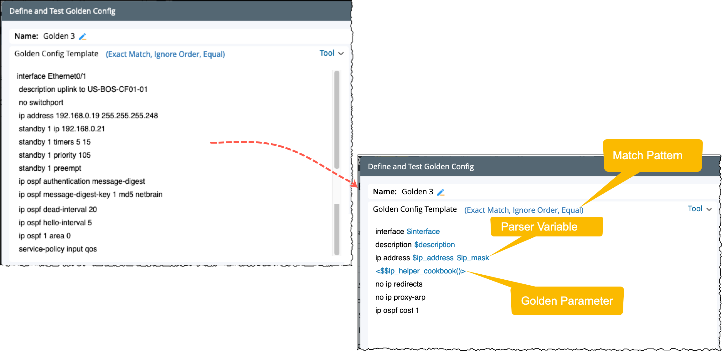

  2. Golden Config Template: While creating the Golden Config, the configuration data is brought over for adjustments. And you can replace the data with parameters/variables to enhance the template matching capability:
    • Match Pattern: Define the pattern to compare target config against the golden config template. The functionality is same as in NI.
    • Insert Parser Variable: You can replace certain data with a variable from the current Config Parser.
    • Insert Golden Parameter: You can insert a variable from the golden parameter (Base Parameter or Config Parameter) that is defined based on match condition. To create additional conditions in the config template, set the variables sourcing from the ADT.

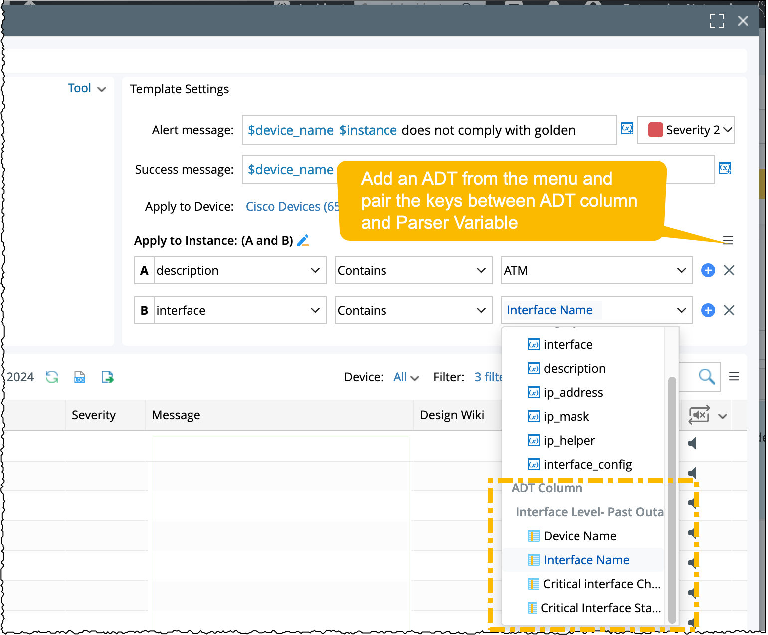

      1. Select  an config parser from the left side of the pane, go to Input Variable Setting and open the menu .
      2. Click Select ADT and choose an ADT Table.
      3. Choose a column to be used as the Device Column from the drop-down menu.
      4. Pair the ADT column with the variable in the parser table, to pass the value.
      5. The final Golden config Template will be:

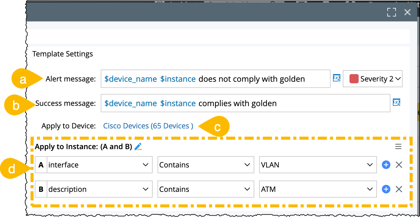

  3. Template Settings: In the Template Settings, you can define the Alert Message, Success Message, applicable device groups, and applicable instance condition for the current Golden Config Template.
    1. Alert Message: The severity level can be defined to display whenever an alert is generated. Security levels are categorized into Severity1 and other levels.
    2. Success Message: Define the Success Message to appear upon successful completion.
    3. Both the Alert Message and Success Message can include the main variables such as Parser Variable, Golden Parameter Information, ADT Table Variables, Match Pattern Return Values.
    4. Apply to Device: Define the applicable devices via selected device group. The current template will be applied to these devices.
    5. Apply to Instance: Only the instances matching with this condition will be verified against the golden config template.
      You can configure the condition with variables from ADT to enhance the data from the parser table. To use the data from ADT, define the key from the ADT and parser table and pair them together. Multiple keys can be configured to specify the correspondence with parser table.

The final Define and Test Golden Config will be:
