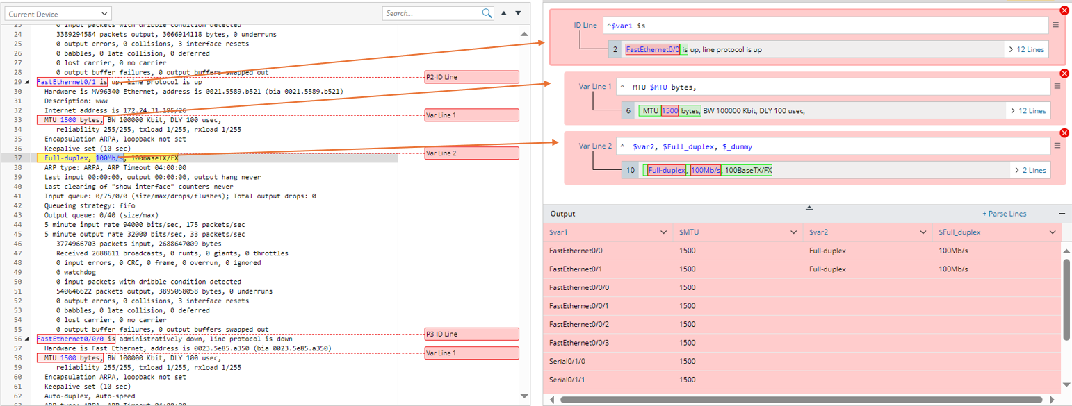

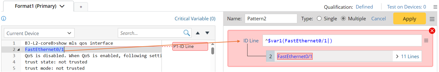

For example, to parse enumeration-type variables like $duplex , you can use $duplex(Full-duplex|Half-duplex|Auto-duplex)” in the variable line pattern. Following the steps below to complete the settings in this example.
  1. In the Sample text area, double-click FastEthernet0/1 in line 29 to create an ID line, double-click 1500 in line 33 to create Var Line 1, then select Full-duplex and 100Mb/s in line 37 to create Var Line 2.
  2. Define Enumeration for Var Line 2:
    1. In the output area, click the variable column name $var2. In the pop-up window, change the variable name to $duplex and define the Enumeration to Full-duplex|Auto-duplex
    2. Click Apply to close the window and apply the settings.

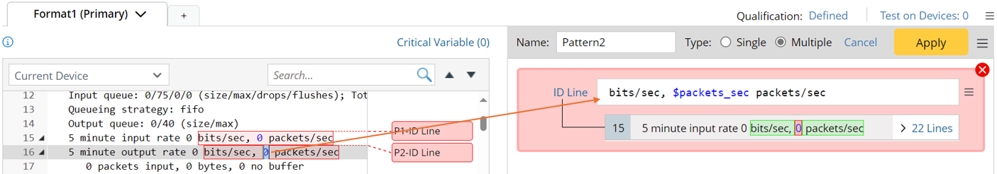

A Dummy variable is a virtual variable in the shape of $type:_dummy in a line pattern and will not be extracted as a Parser variable.
You can use a dummy variable to skip a specific type of variable you are not interested in, like a placeholder. For example:
  • $mstring:_dummy indicates skipping multiple lines of string.
  • $string:_dummy($_dummy) indicates to skip a string.
  • $int:_dummy indicates to skip an integer.
  • $float:_dummy indicates to skip a float.

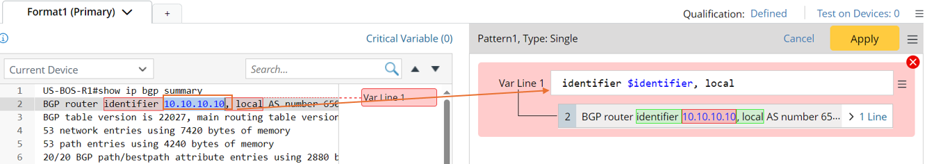

Add Variables
During parsing variables, line patterns will be automatically generated by parsing the variable and finding anchors (which will be used as the keywords for filtering variables from the parser input).

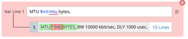

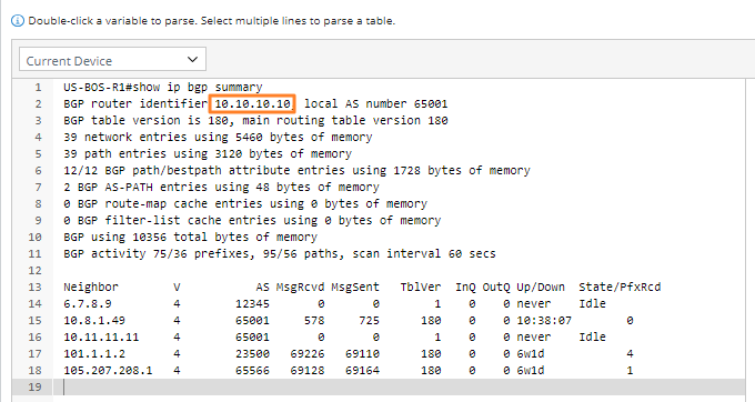

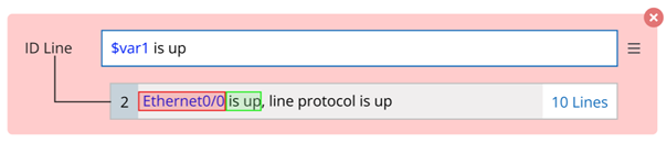

  • When one word is selected from one line as a variable (double-click the word in the parser input area), a typical line pattern is generated in the form “anchor + variable + anchor”. For example, in the sample data below, if 10.10.10.10 is selected as variable, the line pattern identifier $identifier, local will be generated.
  • If you select words several times for parsing variables and the selected words are in one line, the variables will be merged into one line pattern. For example, in the sample data below, if “10.10.10.10” and “65001” in the same line are selected as variables, the line pattern “identifier $identifier1, local $mstring:_dummy number $int:number” will be generated.

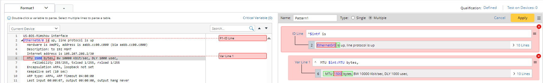

  • If a new selected variable is not in the same line with the existing variables, a new line pattern will be generated for the new variable. For example, in the sample data below, double-click “Ethernet0/0” to add line pattern “^$var1 is” first, then double-click “1500”, a new line pattern “^ MTU $int:MTU bytes,” will be generated.
    Information Note: If a number is selected as variable, the system will automatically generate a variable of “$int” type, like $int:mtu.

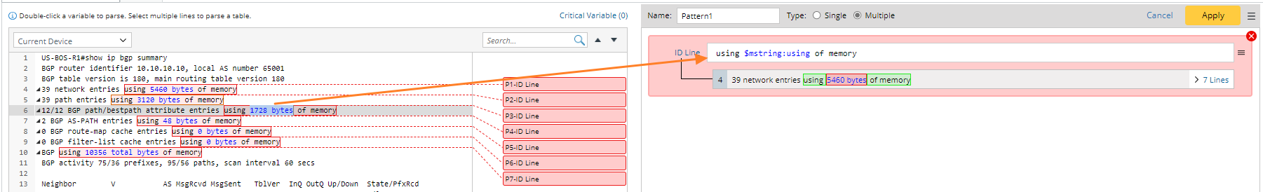

  • If several words are selected as a variable, the variable type will be automatically set to “$mstring”. For example, in the sample data below, if “1728 bytes” are selected as a variable, which are two distinct words, the line pattern “using $mstring: using of memory” will be generated.

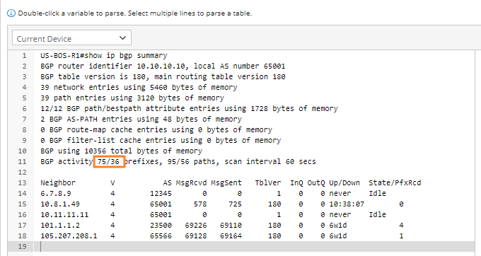

  • The words beside selected variable will be considered as anchor if they are “String” or “String + Special Character” type. For example, if the word “75/36” is selected as variable, the word “activity” at the left side is in string format, and word “prefixes” at the right side is in "string + special characters" format, so these two words can be set as anchor to identify the selected variable.

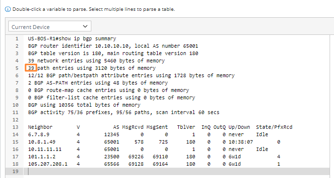

  • If no word before the selected word can be used as anchor, ^ will be added as anchor. For example, if 39 is selected, and there is no suitable anchor before it, ^ is added as the anchor. Line pattern ^$int:path path is generated.

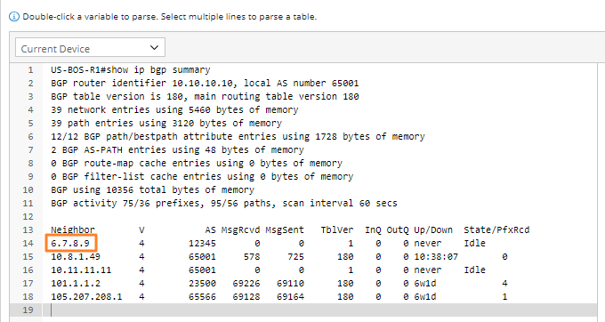

  • If the word before or after the selected word is of the types (“Number”, “String + Number”, “Number + Special Character”, or “String + Number + Character”), the system will skip this type of word ($_dummy will be used to replace these words) and continue to find anchor. For example, if 6.7.8.9 is selected, the line pattern “^$var2 $_dummy $_dummy $_dummy $_dummy $_dummy $_dummy $_dummy never” is generated.

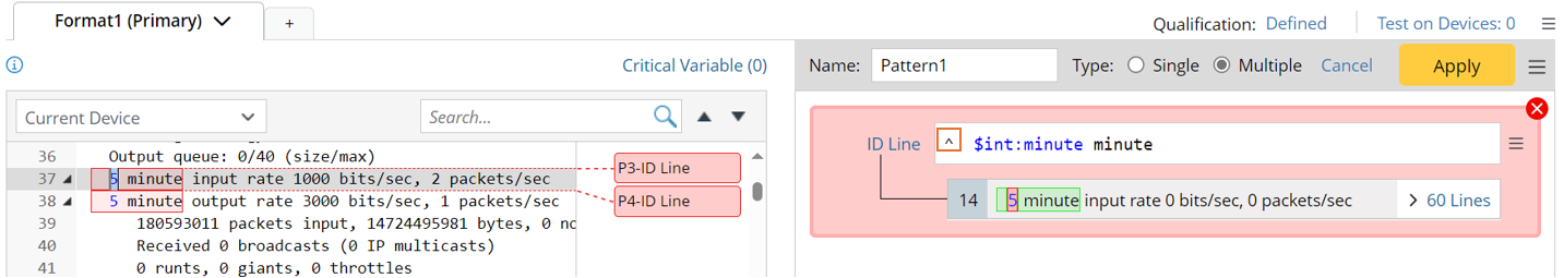

When there is no keyword before and after a target variable in one line of raw text, that is, the variable is the only string in that line, you can use the character ^ to represent the start of a line and use the character $ to represent the end of a line when defining the line pattern.
Take the following Paragraph Parser as an example: the parent line pattern only contains a variable of interface name (note that there is space before and after the variable).
  • To define the parent line pattern, you can use “^ $int: minute”, which means the variable starts with a space.
  • You can use $Timeout$ in the line pattern, where the second $ means the end of this line pattern.
