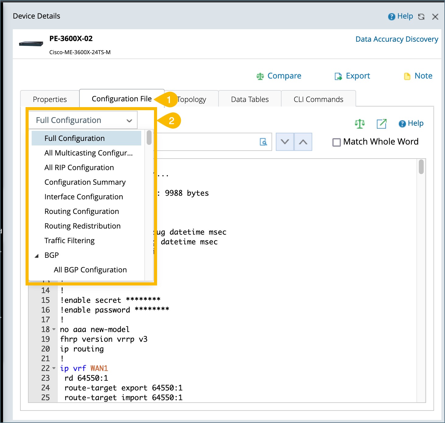

Browse Configuration File
- In the Device Details pane, select the Configuration File tab. The full configuration file of the device is displayed by default.
- Select a technology from the drop-list to filter the configurations.

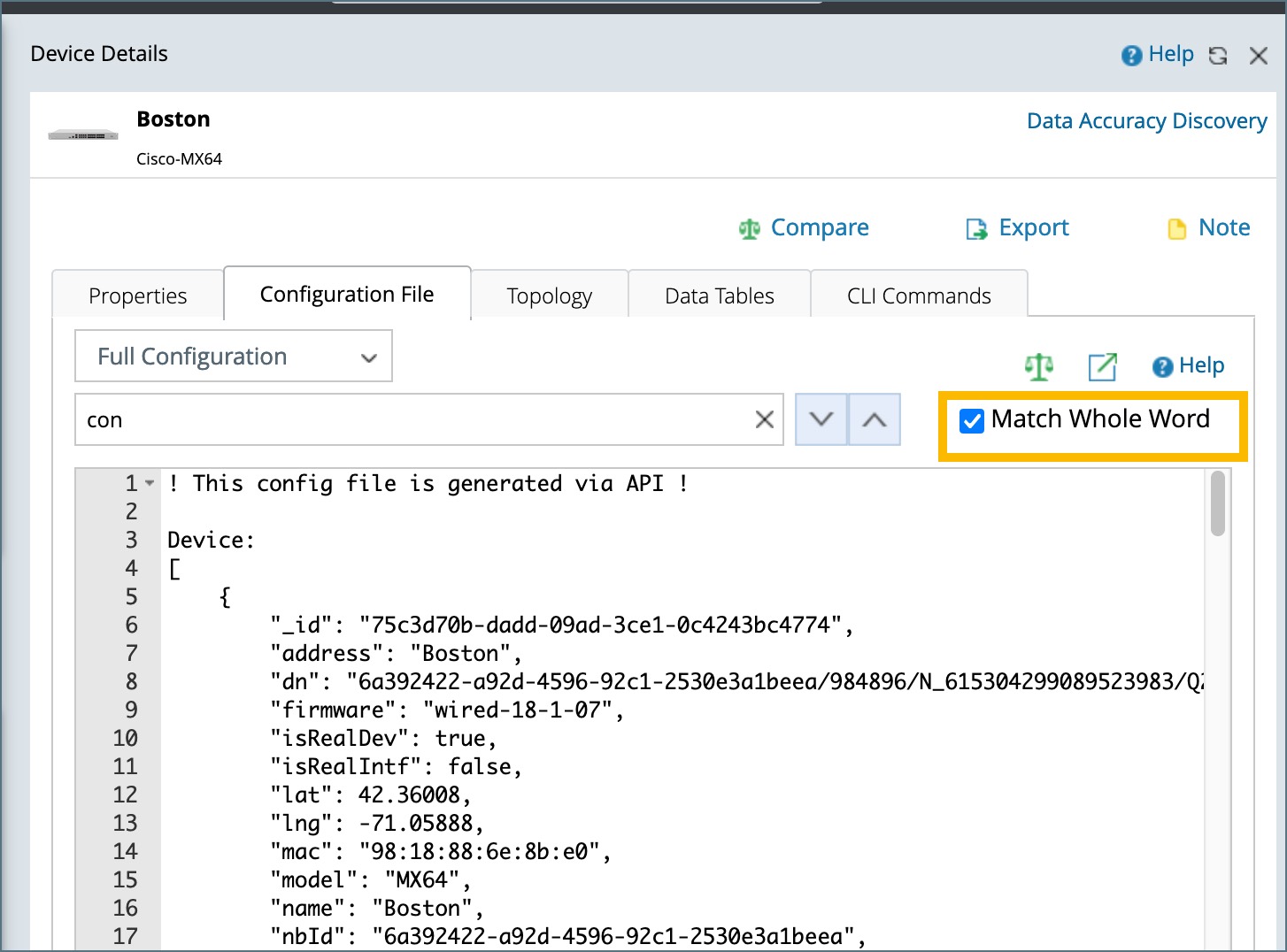

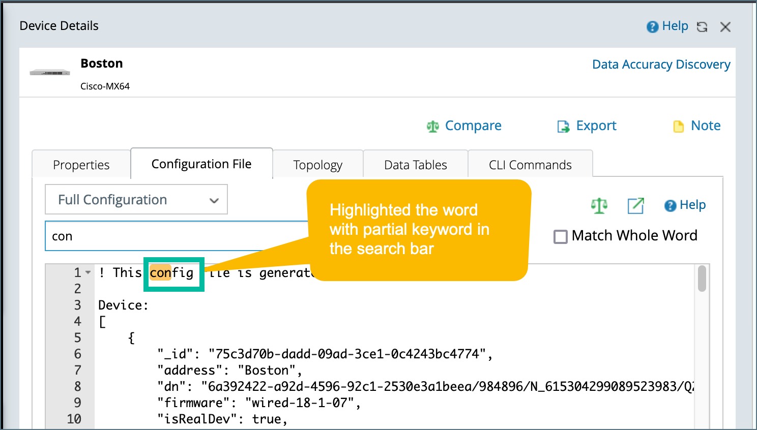

Search Key Words in Configuration File
For the Configuration file, you can search keywords with:
Normal Search: Type the keyword in the search bar, and the system will highlight all words containing the whole or partial keyword. You can use
to easily browse the next or the previous highlighted items.
Match Whole Word: Type the keyword in the search bar, and the system will only highlight the words that exactly match the whole keyword. You can use

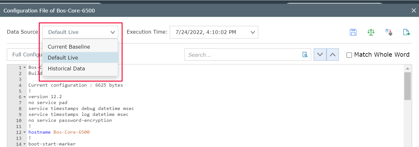

Retrieve Configuration Files from the Live Network
In the Device Detail pane, click
to open the pop-up window.
Click
to retrieve live configuration.
- You can also review configuration files from different Data source and Execution time.

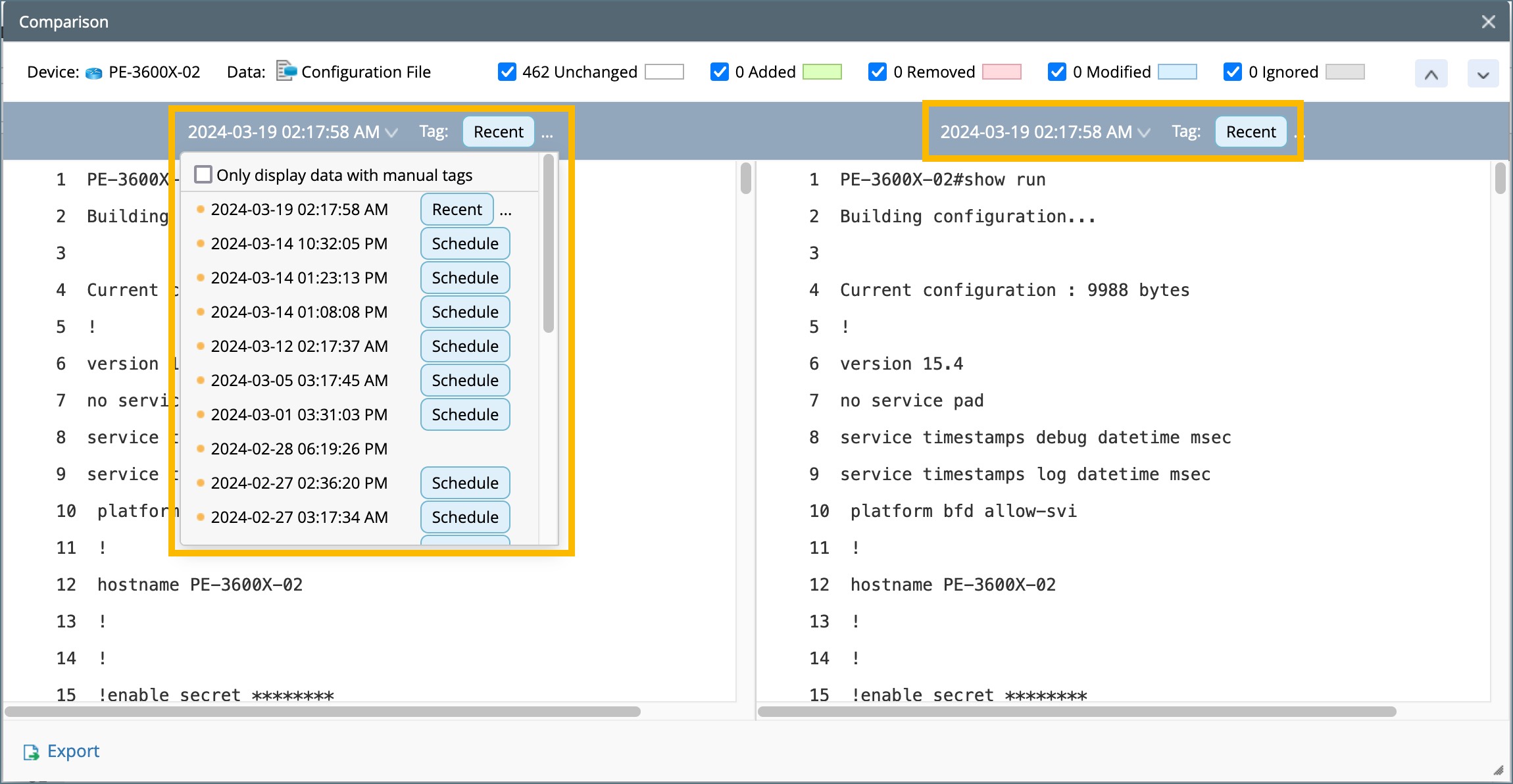

Compare Historical Configuration Files
Click
to open Compare window.

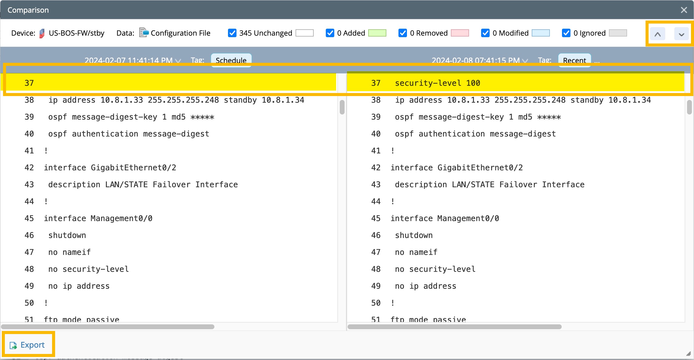

- You can select the configuration file from different times to compare.
Use
to find the next changed item. You can also export the comparison result.

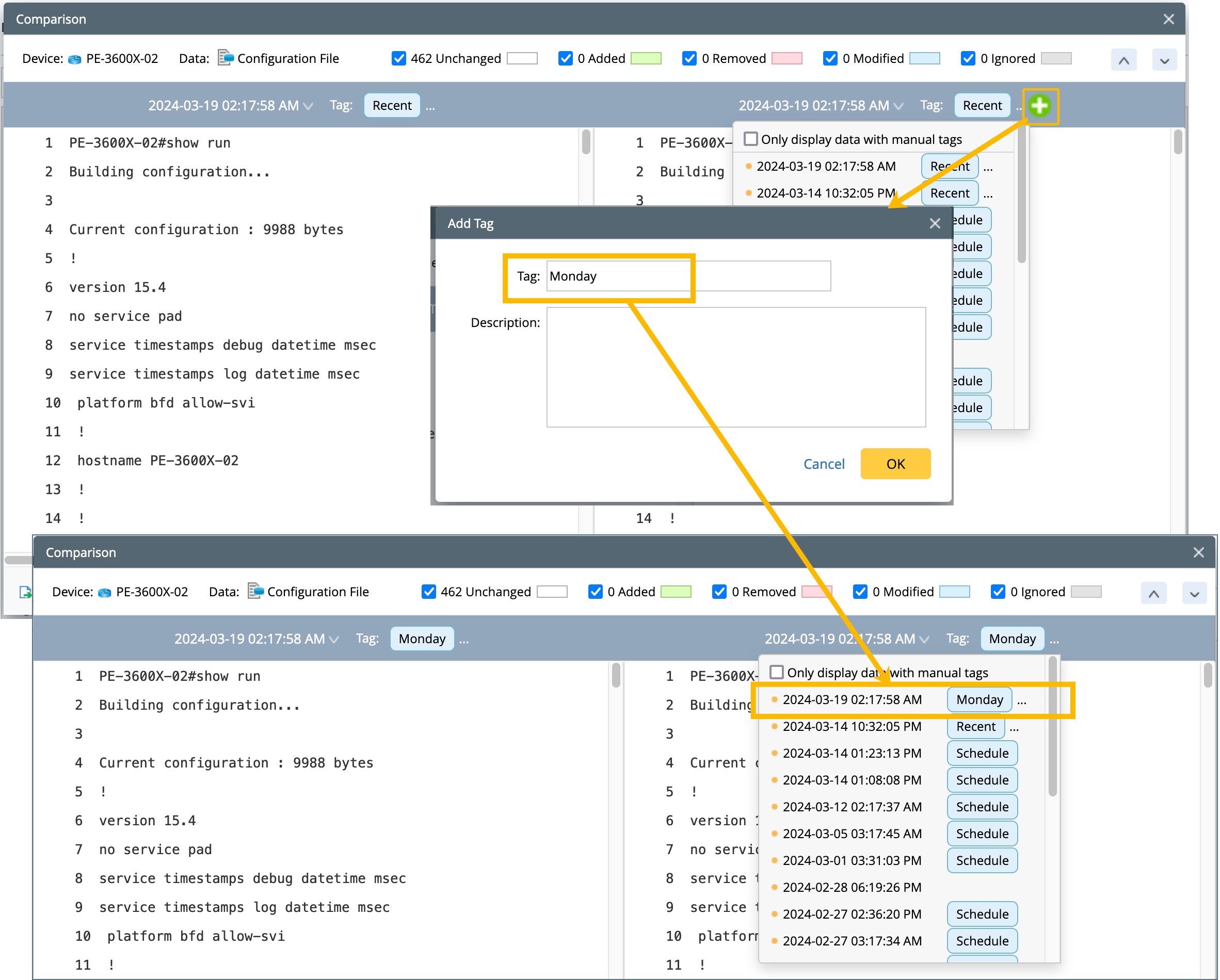

Tip: You can use the Manual Tag function to help you find the data you want. When you manually add tags to data, you can filter out the data with a manual tag.
