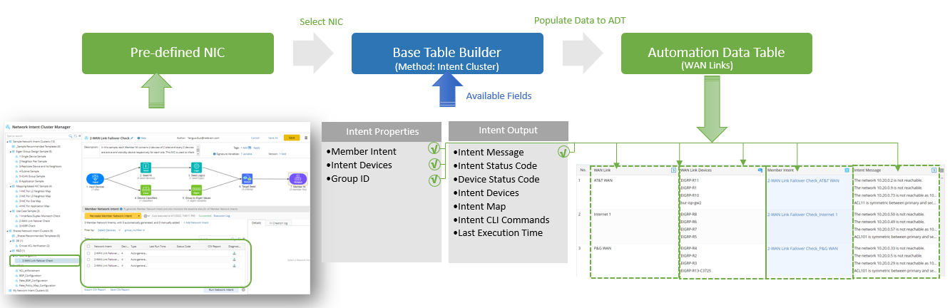

When member intents of an intent cluster contain the critical network assets or properties useful to solve a repeatable network problem, this intent cluster can be used to create an ADT to populate the useful data, such as source device properties.
TimelineDescription automatically generated
Define Base Table via Intent Cluster
The eigen variables used for intent cluster decoding can fill the table rows. The member intents, member intent devices, and signature values are built-in data sources. Intents outputs can also be added to ADT.

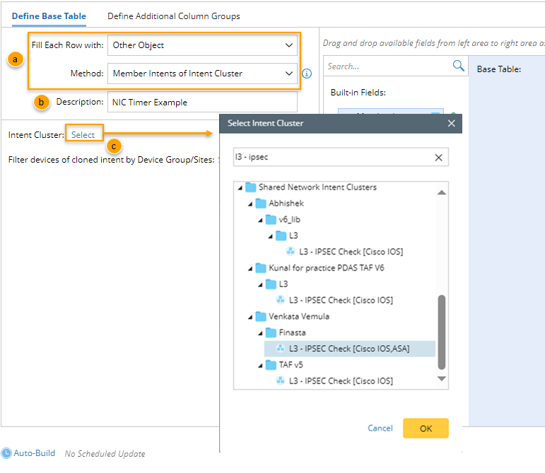

  1. Go to Automation Data Table Manager, then create a new table and name it (for example NIC Timer).
  2. Go to Automation Data Table Builder > Define Base Table the created ADT.
  3. Under the Define Base Table tab, define the following settings:
    1. Select Method to Build Base Table: Select Other Object > Member Intents of Intent Cluster.
    2. Description: Input descriptions for the base table to describe its use and function.
    3. Intent Cluster: Select the created intent cluster for building the base table.
  4. Mapping Available Fields to Column Group: Drag and drop the available fields to the column group definition area to create ADT columns automatically.

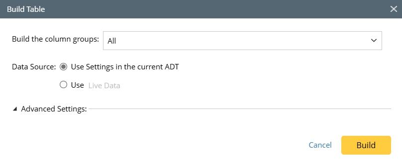

  2. Click Save and Build to save all the settings and build the base table data.
