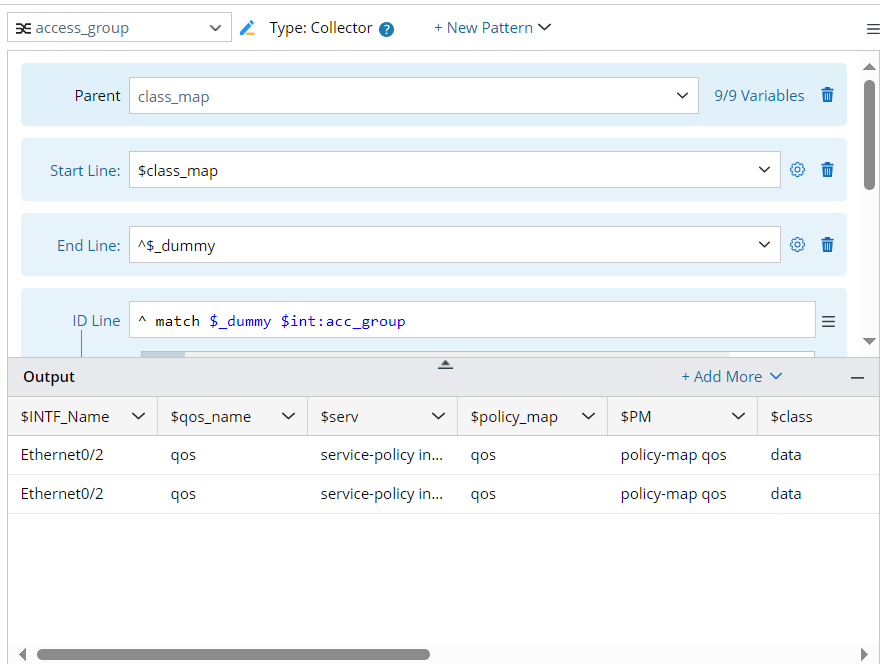

The following output table needs to be simplified by merging some rows and remove some redundant columns.

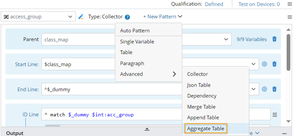

  1. Click +New Pattern > Advanced > Aggregate Table to create an empty aggregate table pattern.

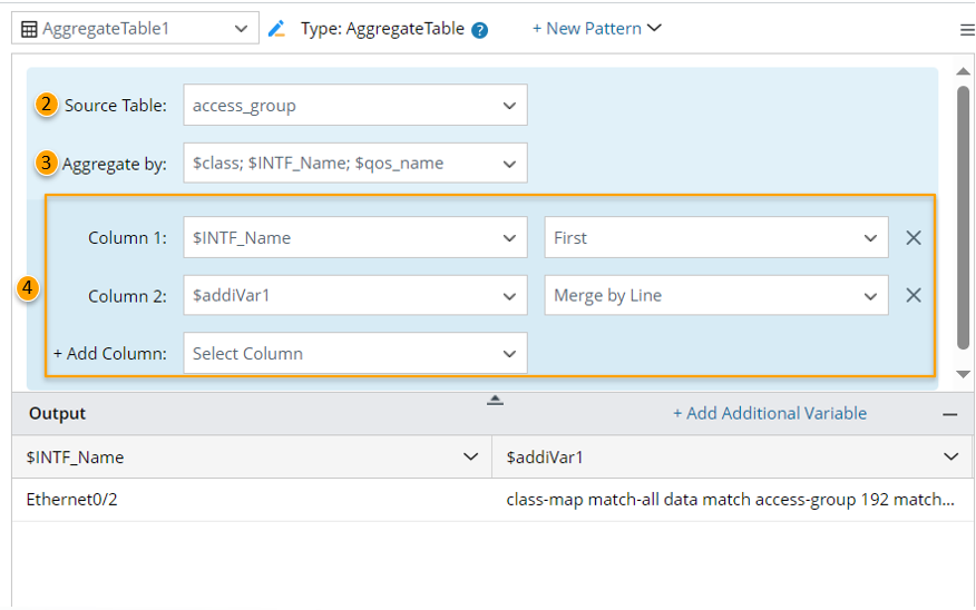

  2. In the Source Table field, click the icon, then select the output table access_group as the source table to operate on.

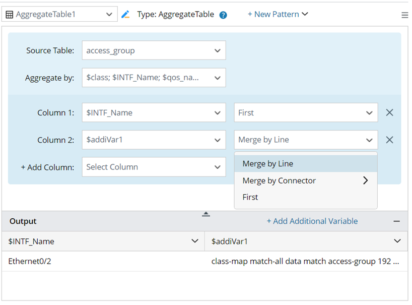

  3. In the Aggregate by field, click the  icon, then select columns from the source table, then the values in these columns will be taken as reference when table is aggregated.
  4. Click +Add Column to add columns to aggregate to the source table, then select the method of aggregate each column. By default, all columns of the source table will be listed here, you can click the  icon to remove unnecessary columns.
    • Select the $INTF_Name column and the First method.
    • Select the $addVar1 column and the Merge by Line method.

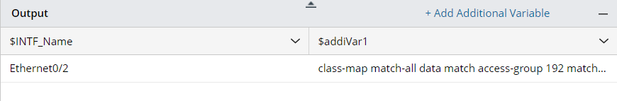

  5. View the aggregated final output table as shown below, then click the  icon to save the parser.
