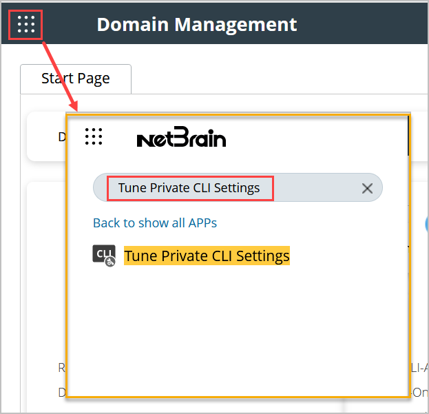

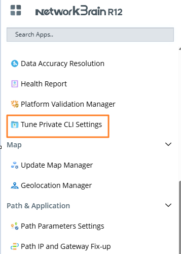

  2. From the Taskbar, search and find Tune Private CLI Settings.

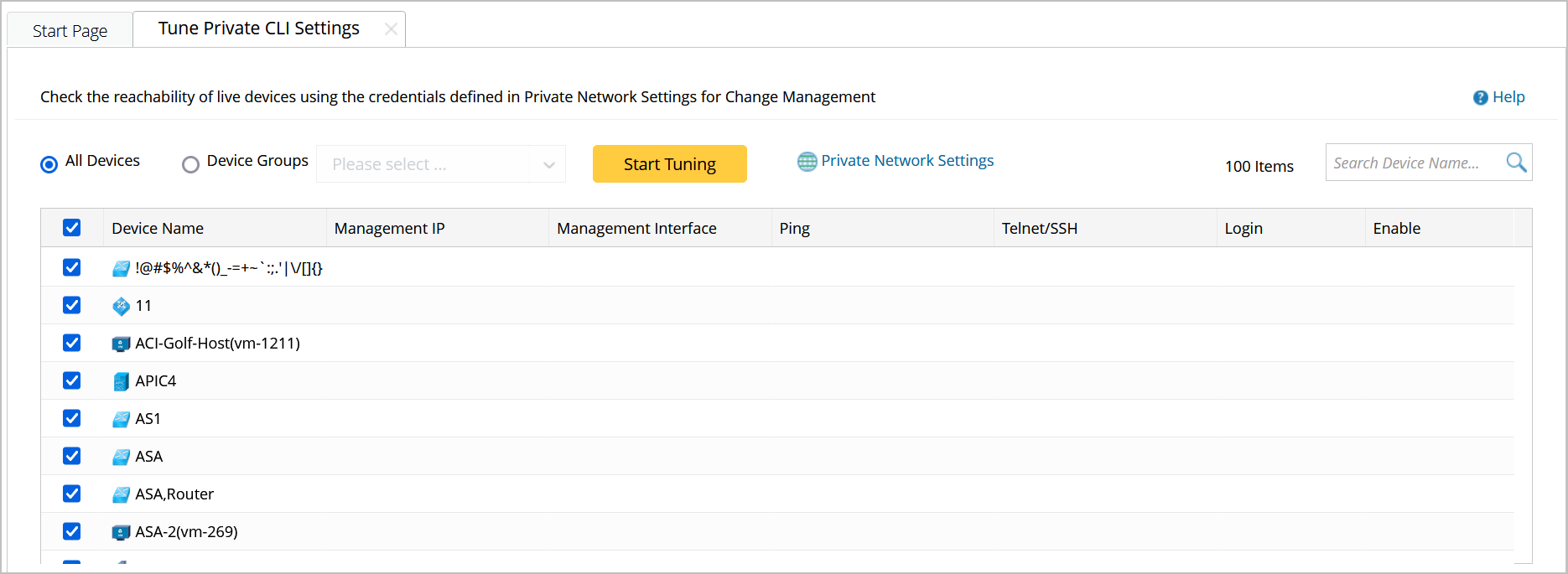

  3. On the Tune Private CLI Settings tab, all devices in the domain are selected by default. You can select devices manually or by device group.
  4. Click Private Network Settings to define your private access credentials. See Configure Private Network Settings for more details.
    Information Note: The Private Network Settings are only accessible for domain admins, power users, network change executors and other users with the network change executing privilege when private credentials are selected in Network Change Credentials Management.
  5. Click Start Tuning. After the tuning process of a device is completed, you can click the corresponding entry in the table to view the detailed log of the tuning process at the bottom.
