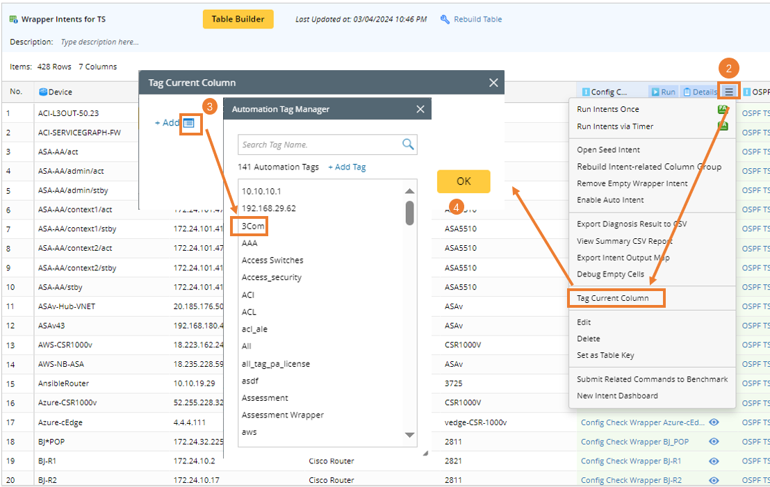

Tag Automation Column
Open the Tag Current Column dialog from the drop-down menu of the target automation column, then enter the tags.
  1. Open the target ADT in ADT Manager.
  2. From the drop-down column of the automation column, select Tag Current Column
  3. In the pop-up dialog, click the icon to select tags (for example, tag "3Com") from the drop-down list.
  4. Click OK to add the tags.

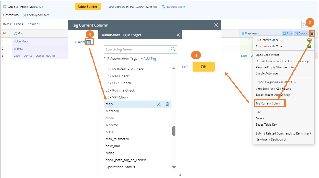

Tag Map Column or Map Automation Column
Tag Current Column dialog from the drop-down menu of the target map column or map automation column, then enter the tags.
  2. From the drop-down column of the automation column, select Tag Current Column.
  3. In the pop-up dialog, click the icon to select tags (for example, tag "Map") from the drop-down list.
