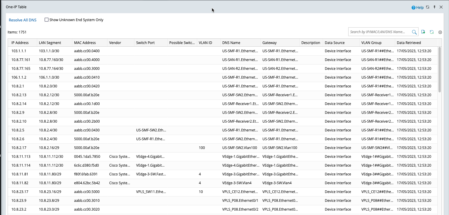

One-IP Table
The One-IP table records all IP addresses in the current domain discovered by the system and their properties, including LAN segment, MAC address, vendor, connected switch port, VLAN ID, DNS name, description, and VLAN group. The IP address can belong to L3 interfaces and end systems. The one-IP table is generated based on ARP and MAC tables when the system builds Layer 2 topology in the benchmark process and is accessible to all IE users. You can use the One-IP table to troubleshoot L2 connectivity issues, locate abnormal IP traffic, etc.
A screenshot of a computerDescription automatically generated

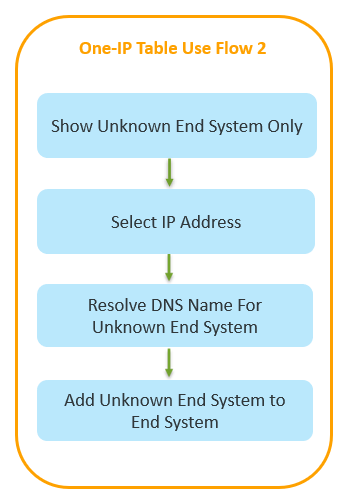

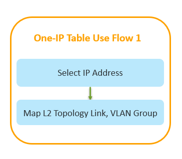

Main Use Flows
The following two diagrams describe two typical use flows of the One-IP table:
Diagram
Diagram
