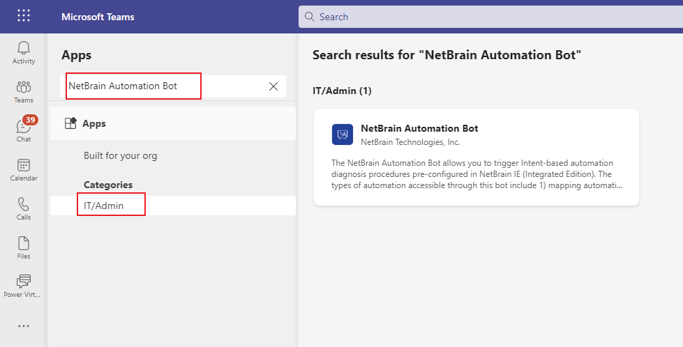

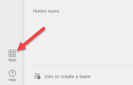

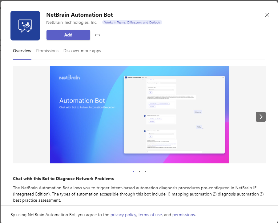

Go to the Apps Store by clicking Apps on the lower left corner.
In the Apps Store, search for NetBrain Automation Bot.
Click Add.

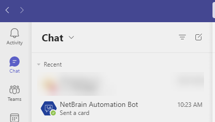

The NetBrain Automation Bot is listed under Chat and you can start to chat with the bot.

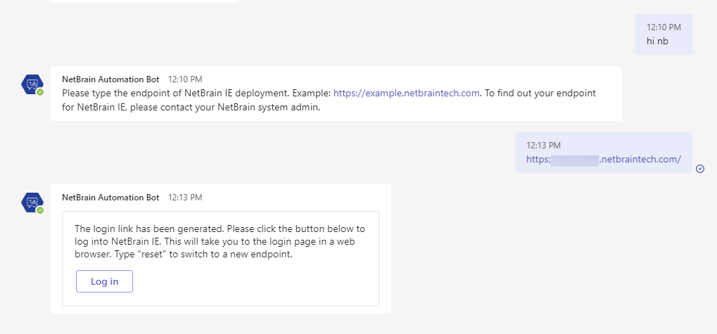

To wake up the Bot, type" Hi NetBrain" or "hi nb".
Tip: The commands in the Bot are NOT case sensitive.
The Bot will prompt you to enter your NetBrain endpoint
Tip: If you have difficulties finding the endpoint, please contact your NetBrain system admin.
- Click Log in Button, and it will take you to the login page in a web browser.
Input your NetBrain account credentials and click Log in.

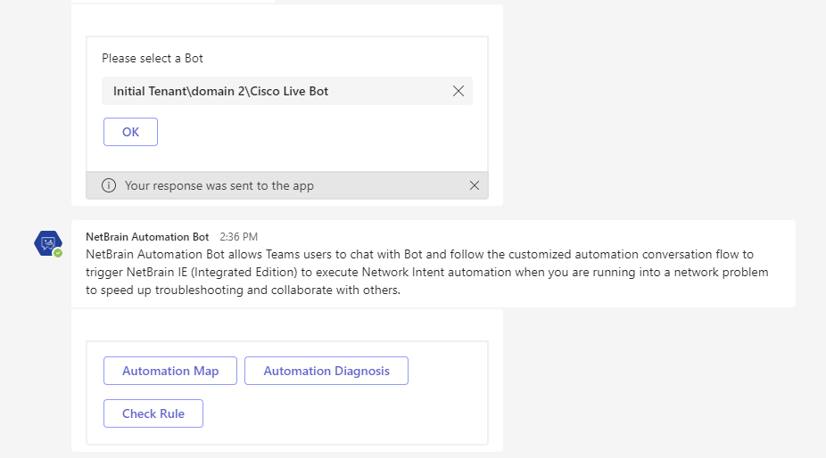

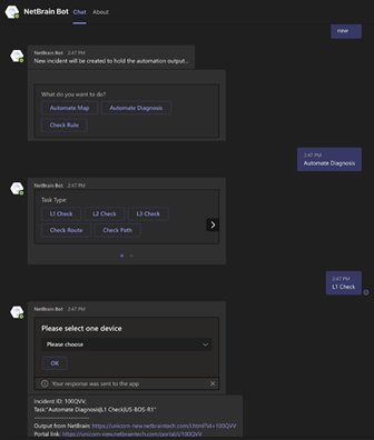

After logging in successfully, you can select a Bot that was pre-customized in NetBrain to trigger automation diagnosis.
Follow the link to open the NetBrain map or incident portal.
