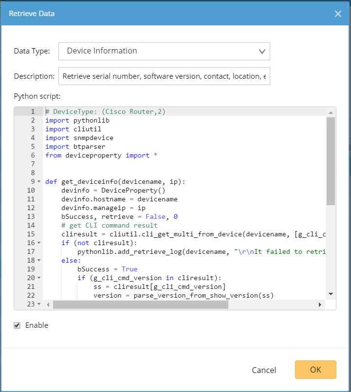

Advanced Tab
The Advanced tab specifies the python scripts used to retrieve device information (such as serial number and software version) and interface data (such as interface speed and duplex) of the same device type.
