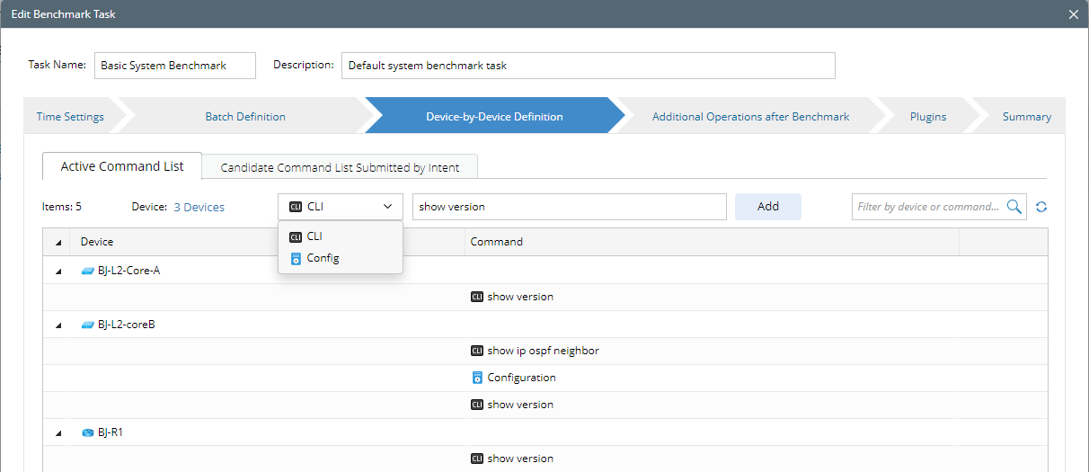

Device-by-Device Definition
Compared with adding commands to a device type on Batch Definition tab, you can add commands to specific devices on Device-by-Device Definition tab.
Active Command List:
This tab allows you to manually add the device and command pair, and the command list of each device can be different based on the actual definition. Only CLI command and configuration are supported here.

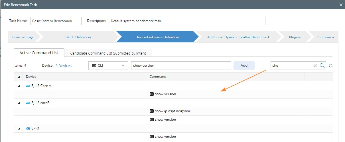

You can only view the required data via filtering by device or command with incomplete match in the upper-right corner when there are large data.

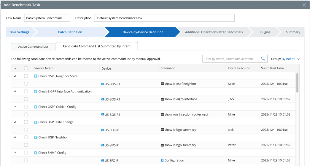

Candidate Command List Submitted by Intent:
The commands under this tab are submitted by executing intents and cannot be manually added. These commands cannot be directly adopted in the benchmark task until you click Approve to move them to the Active Command List.
You can also delete these commands by clicking Reject. The command information, such as source intent, intent executor, and submitted time, is displayed, and can help determine whether to approve or reject the commands.

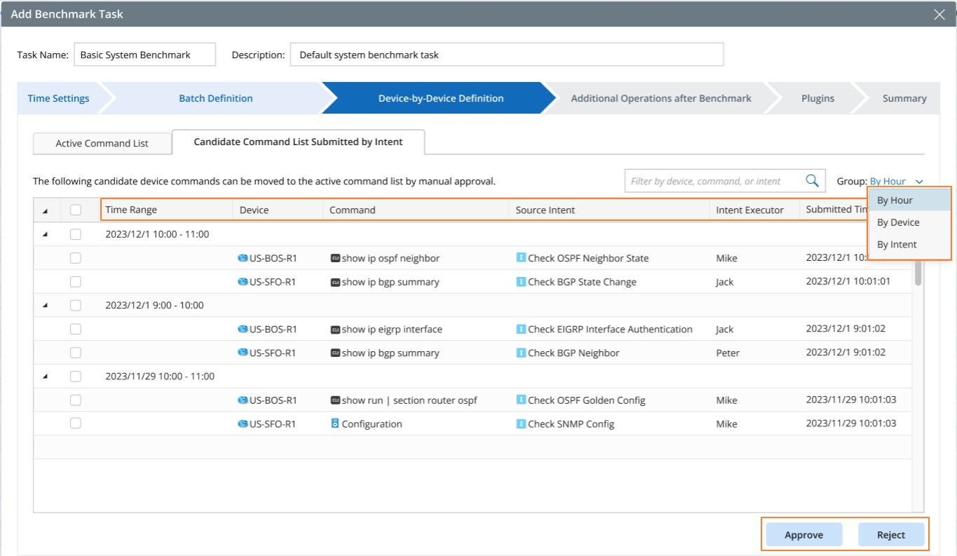

Group Candidate Commands
You can group the candidate commands by the following three methods:
  • By hour: This is the default method and commands are grouped according to the submitted hour.

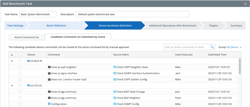

  • By device: The commands are grouped according to the devices they belong to.
  • By intent: The commands are grouped according to the source intents they are submitted from.
