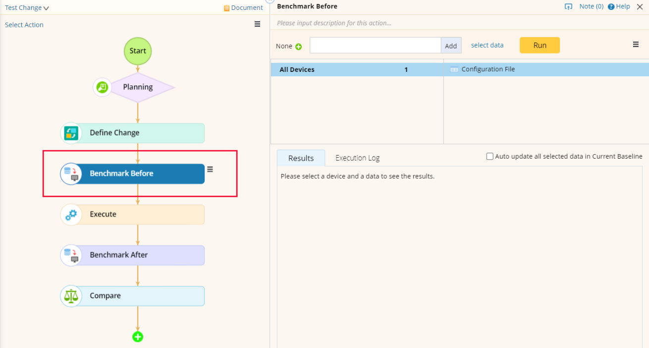

  1. Select the Benchmark Before node in the runbook.

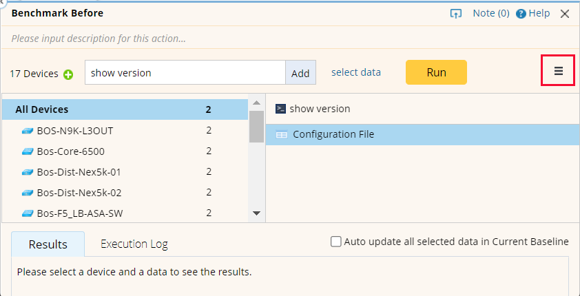

    1. Click the  icon to select the target devices for the benchmark.

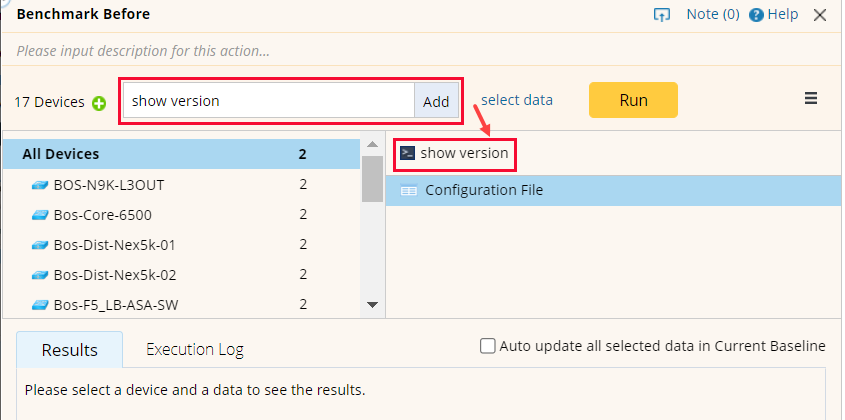

    2. Add CLI commands using either way:
    • Manually enter a CLI command and click Add. You can add multiple commands.
    • Click the  icon to select Load CLI Templates to batch add commands.

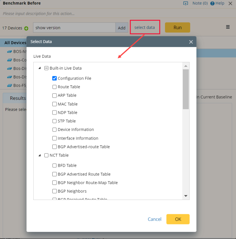

    1. Click select data to select the data types that you want to retrieve.

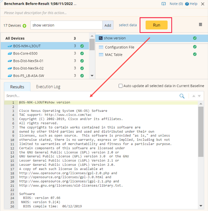

    2. Click Run to execute the Benchmark task and view the results.
