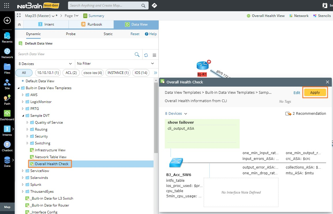

Define Golden Baseline Rules on Map
After applying a data view template to a map, let’s take the Overall Health Check Data View as an example. You can define Golden Baseline Rule for parser variables and apply the rules to devices/interfaces on the map.

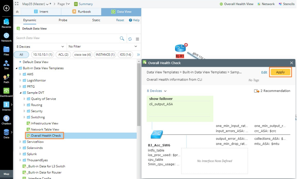

  1. Open a Map and apply the Overall Health Check Data View to the map. Waiting for the Data View to run and return a result.

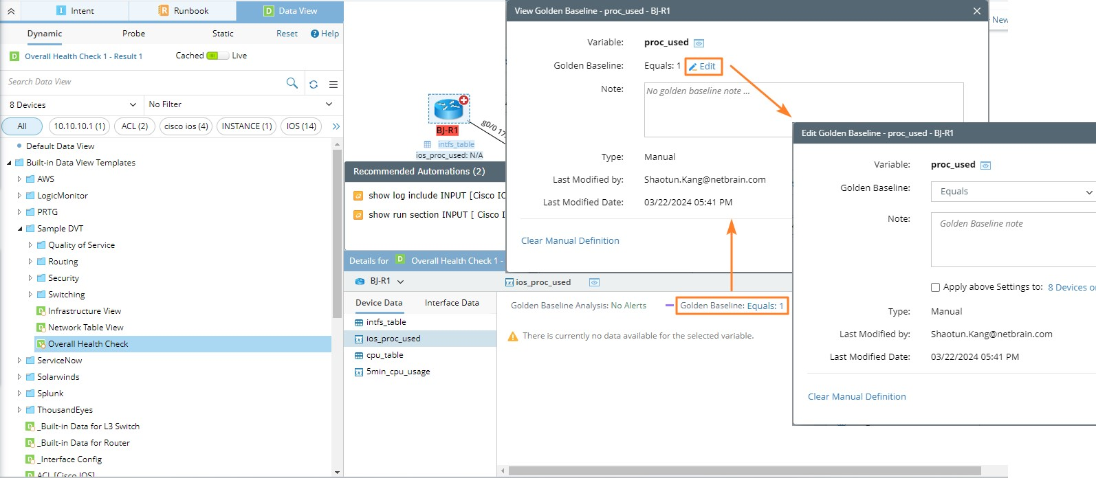

  2. You can manually edit the Golden Baseline.
  3. Information Tip: You can find a detailed explanation for the following rules at Golden Baseline Rules.

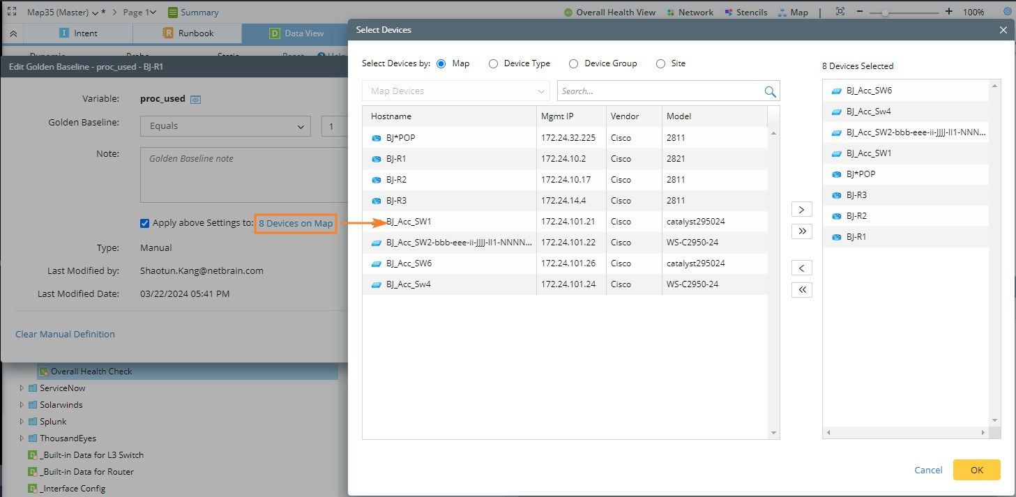

  4. The system allows applying a rule to multiple devices/interfaces, even for those not on the map or not of the same device type.
  5. Information Tip: When Golden Baseline Rules are applied to other device types, the system will look up variable mappings to determine the corresponding variables of those devices.

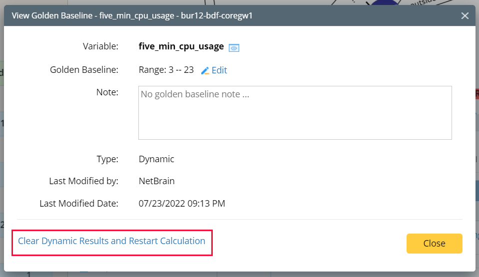

  6. If you do not know a Golden Baseline and wish to use the recently observed data as resources to calculate a Golden Baseline, you can use the following function to have NetBrain System calculate a Golden Baseline for you:

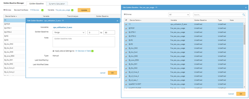

In the Golden Baseline Manager, you can define Golden Baseline Rules for parser variables to a batch of devices/interfaces. The batch of devices/interfaces can be selected per Device Type, Device Group, or Site.

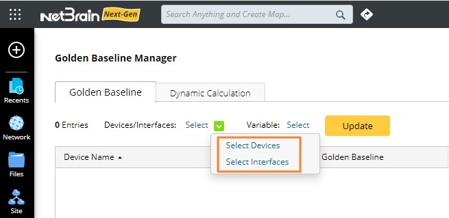

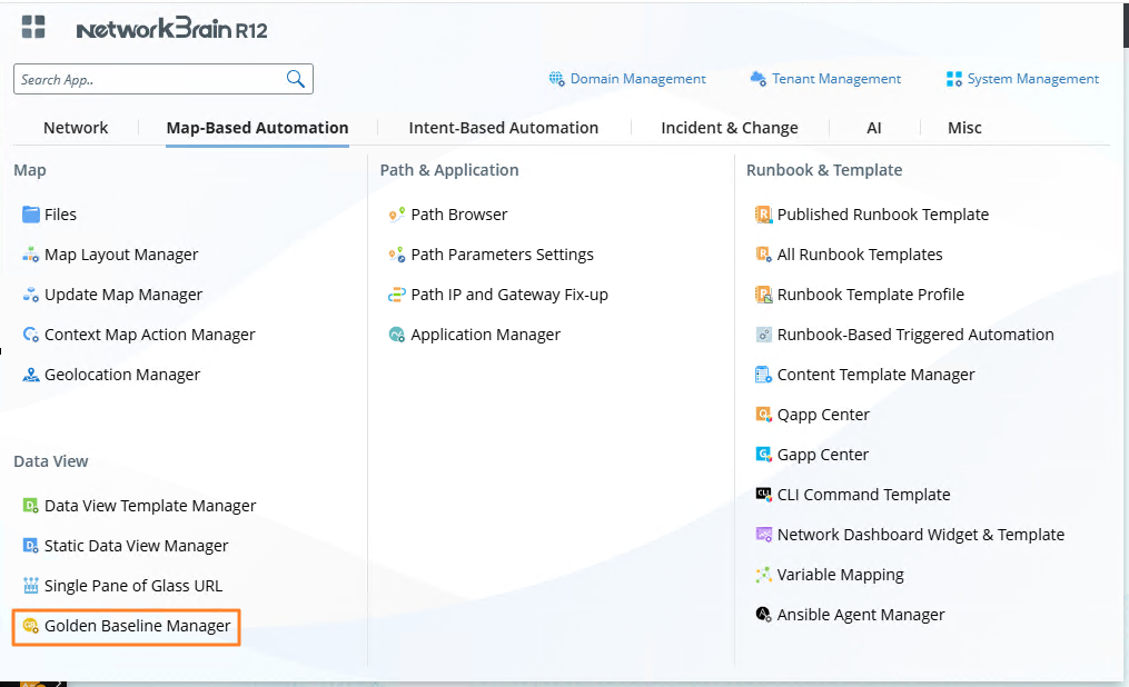

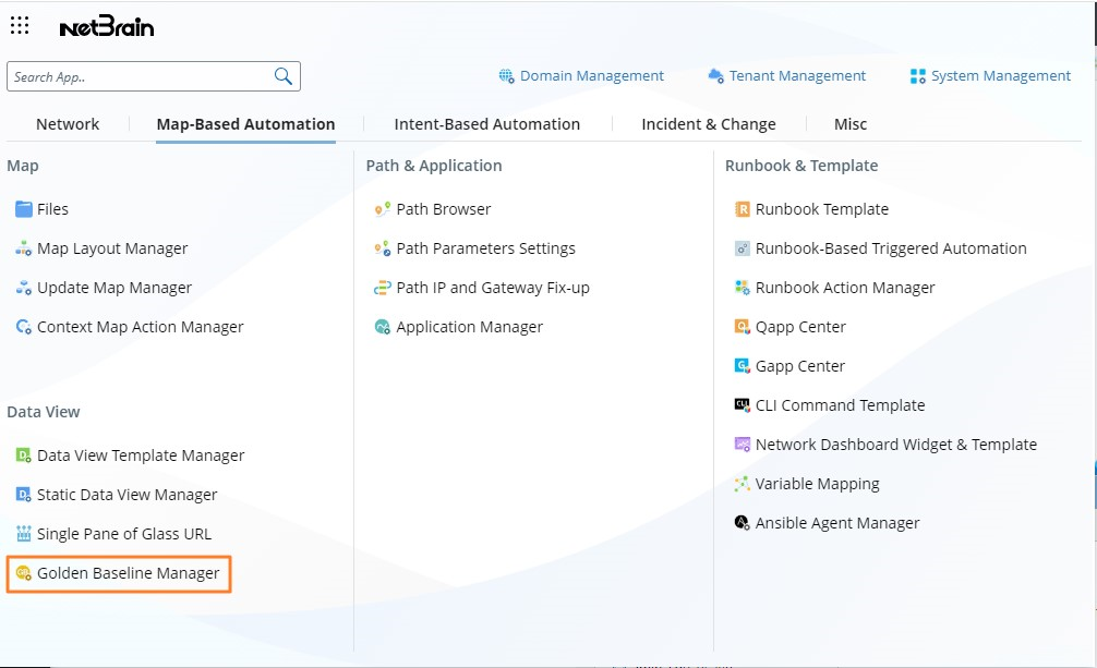

  1. Open Golden Baseline Manager through the Menu on the Desktop.

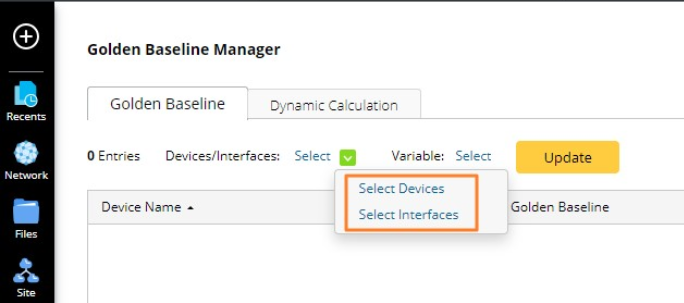

  1. Click to specify what type of data you would like to select.

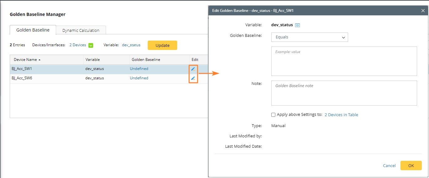

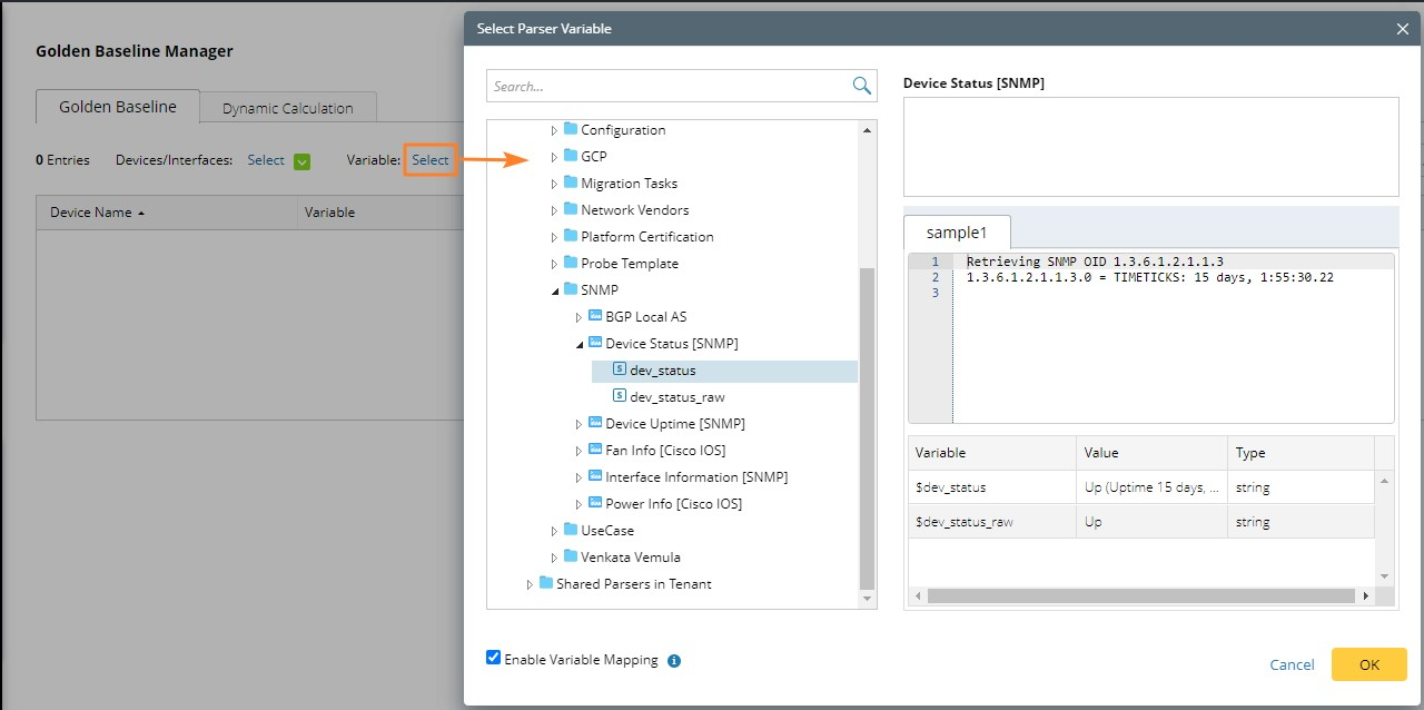

  1. Select variables.
  2. Information Note: Column variables under a paragraph variable are not eligible for Devices. They are only eligible for Interfaces.
  1. Edit Golden Baseline.
